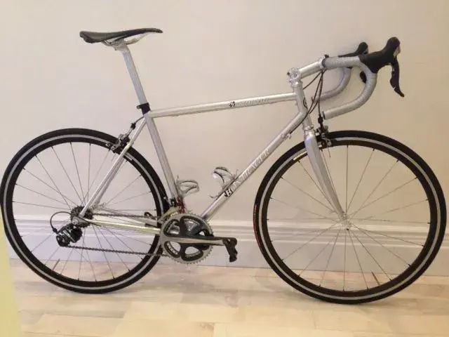

Bontrager Road Lite project COMPLETED
I finally finished my Bontrager Road Lite project. It came out, in my opinion, very nice. I paint matched the fork, stem and post to go for that "module" modern look and it looks nice. It is about 17ish lbs, which is pretty amazing for a steel bike. The Look HSC 3 1" steerer full carbon fork with the proper 40mm rake took me 4 months to find!
I still need to take it out for a shake down ride, so pardon the bad chainline and sloppy cables in the pics. I cannot comment on how it rides yet, but I cannot wait.
Frame: Bontrager Road Lite (year unknown) size M
Fork: Look HSC 3 (custom painted to match frame)
Headset: Chris King NoThreadset
Shifters: Dura Ace 7900
Rear Derailleur: Dura Ace 7900
Front Derailleur: Dura Ace 7900
Crankset: Dura Ace 7900 175, 53/39
Calipers: Dura Ace 7900
Bottom Bracket: Dura Ace 7900 external cup
Chain: Dura Ace HG 7900
Wheelset: Speedcific a.k.a. Kinlin XR300/Novatec with Wheelsmith stainless bladed spokes 20/24
Tires: Vittoria Corsa Evo CX
Cassette: Shimano Ultegra 12-25
Stem: 3T Arc Team (custom painted to match frame)
Bars: Zipp Service Course SL
Post: Bontrager by Titec carbon (custom painted to match frame...also very hard to track down in 26.8)
Saddle: Specialized Romin Expert
Pedals: Look Keo blade
Cages: Zipp
Tape: Fizik
Cables/housing: Yokozuna
