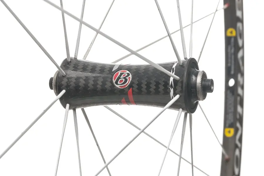

I need to replace a spoke or two on the front wheel - but can't find owt in the way of tech docs to assist disassembly.
I expect it to a tap with a rubber hammer - as I can't see any hex or thread anywhere - but would like to check first.
The hub looks like this and is Bontrager carbon housing DT internals.
Any help much appreciated :)
As far as I'm aware these are just good old DT push together hubs - take the end caps off, knock the axle out and one bearing will come with it, then knock the other bearing out. If they've never been apart the end caps might have stuck themselves onto the axle - you might need a soft jaw vise to pull them off.
But don't hold me to that...
