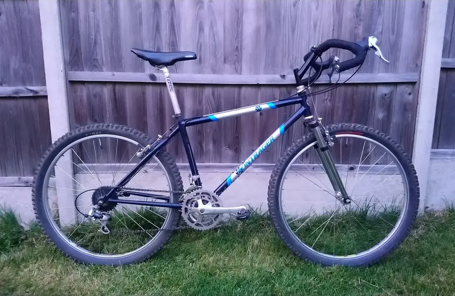

Thought I'd have a try at the drop bar thing on this, think it might need a stem with slightly less reach but I'll give it a go and see what I think. _20220322_182509.webp _20220322_182406.webp
