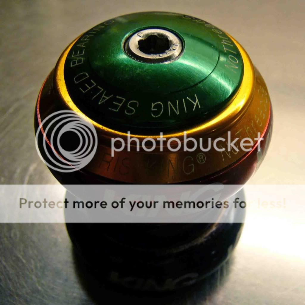

Oh yeah, I had some additional things that also will change.
This rasta Chris King headset for instance. 8)
This will really fit nicely I think.

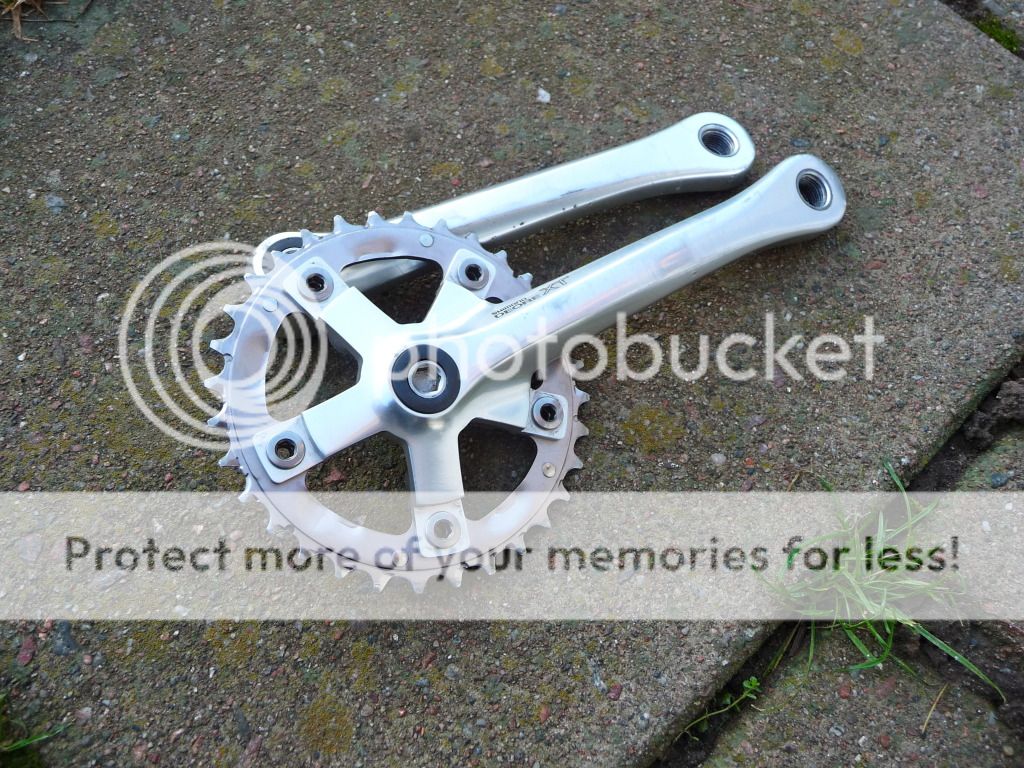

But here´s the crank. It will be more SS specific in the future, but I think this will be a good start to all this.
I´m thinking homebrewed later on, anyone used them?
Crank´s a stock xt M737, and I´ll use the 32T ring for starters.

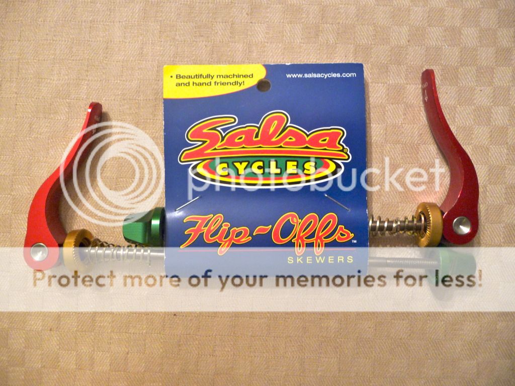

Here´s some color for a rasta rig 8)
I got brand new salsa flip offs that look just gorgeous!
Thanks keepitsteel!
So now I´ve got a rasta bike, rasta headset and rasta skewers.

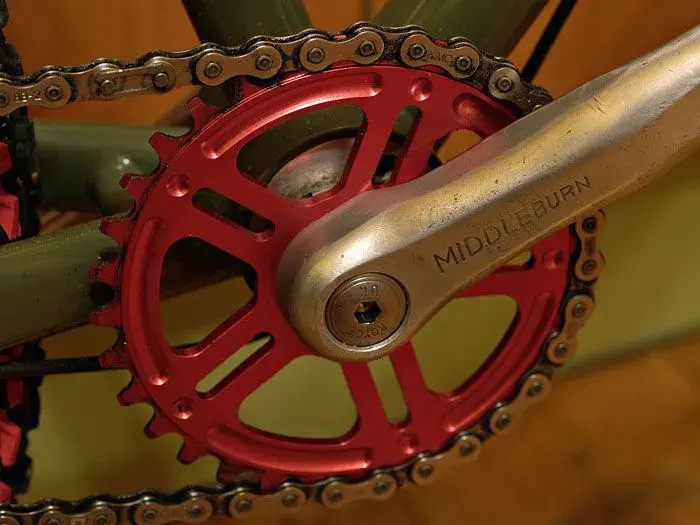

I like the HBC stuff, I have a couple of Dan's chainrings - here's a photograph of a 32T Middleburn spline version.
Fairly long lead times, so if you want one in future, then I'd get it ordered now as you'll probably have to wait a couple of months for it.
In the meantime, I'd get a SS specific chainring rather than use that ramped one. And a KMC Z610HX chain.....
