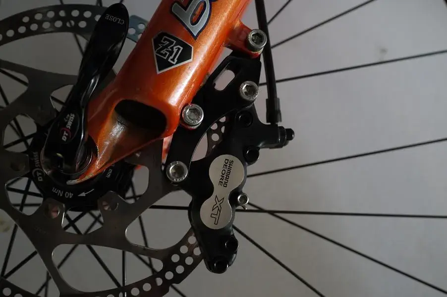

Bomber Z1 disc issue
Is it this you need?
Can probably make one up.
Need to know the positioning of the bolts for the caliper in relation to the fork bolts though.
Are they all like that Dyna-Ti or are there other versions that don't need the second adaptor to fit the brake to?
The only version ive seen is for nonIS-IS like that one but for an IS mount on the caliper :? Post mounts are standard now so its just a matter of adding the adaptor to the adaptor.
I see what you mean though :?
I think that's the easiest way to do it. Otherwise you'd need different nonIS-Post adaptor for each disc size.
I found some Bombers in the garage with this fitting so hopefully I'll make a start next week.
I worked with another retrobike member to for hime to produce this:
