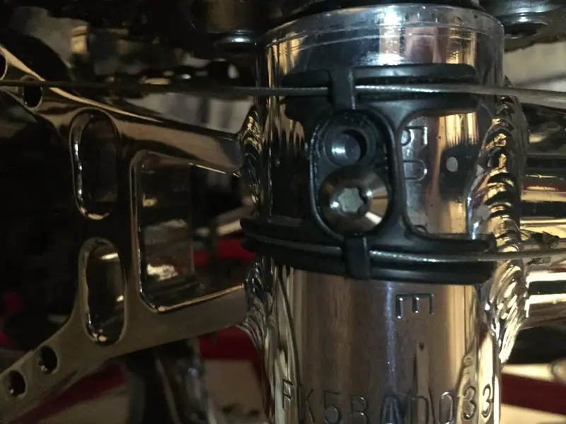

I used a Ti brake rotor bolt.Perfect size with a nice flat profile/wide Torx head.M5 x 10 was long enough without a washer.You've just reminded me of how my M950 BB on my '98 Sworks had to be replaced under warranty as the bolt was a few mm too long and pushed the plastic sleeve up allowing water to pass the o rings. IMG_2125.webp
