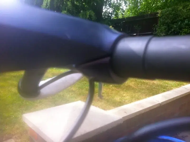

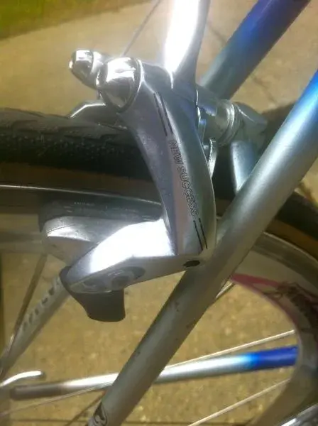

first the brakes, i couldn't get the sachs levers to work with the bar set up, so they had to go, i picked up some cheap dia-compe bar end levers and because of the lever design the cable doesn't go through the inside of the bar but it is underneath the bar tape and looks pretty neat, probably more so when the profile bars are fitted, i have some Profile Century ZB bars, modern but they'll do for now till i find something more in keeping. the brakes are surprisingly powerful aswel.

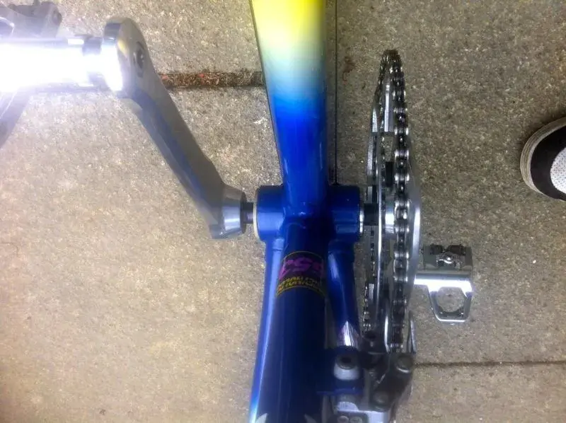

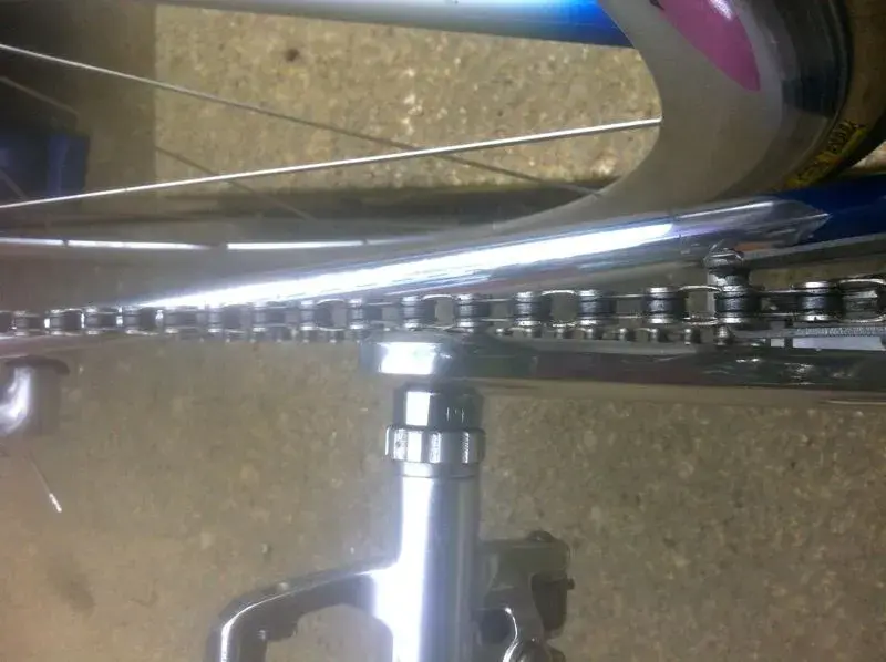

the gears, bit of a nightmare, i originally built this with a 115mm b/b, this gave a pretty good central chainline but the front mech hit the inside of the crank arm, or if adjusted rubbed the chain constantly, also the short chainstays meant that the inside of the crank arm where the pedal thread is catches the chain still at the 10 o'clock position, i decided to sacrifice the chainline to suit the top ring more, currently there is a 122.5mm b/b in the bike, vast improvement and does still work ok in the inside ring although it still catches the inside of the bottom of the crank in top gear, short chainstays being the issue i think but the front mech problems seem to be a lot less but still need more tweaking.

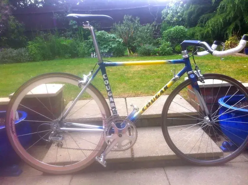

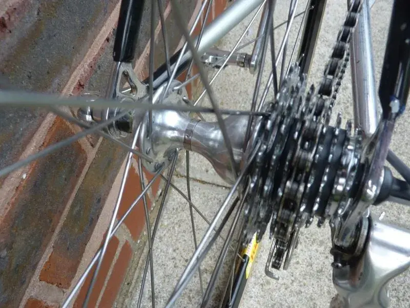

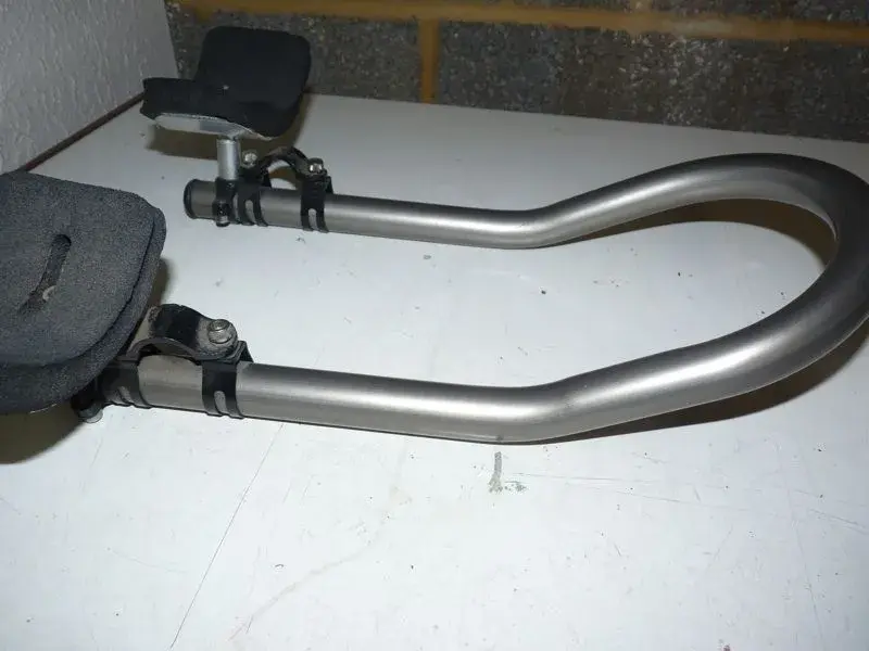

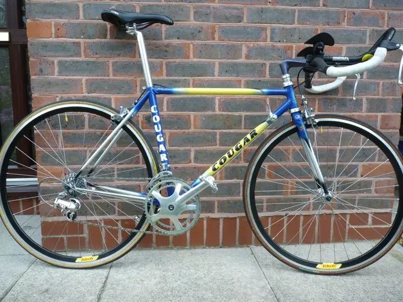

so i've done a little more to this, one of the things that really was bugging was the miss-matched wheels. so i decided to rip apart a pair of wheels i have with record hubs and rebuild them with a pair of matching velocity rims, well apart from the size difference.
there are some other things i need to sort aswel, i'd prefer a nicer seat post and i have a set of mavic profile bars but there are a couple of shaped washers missing so i can't fit them yet.
anyway here's an picture update

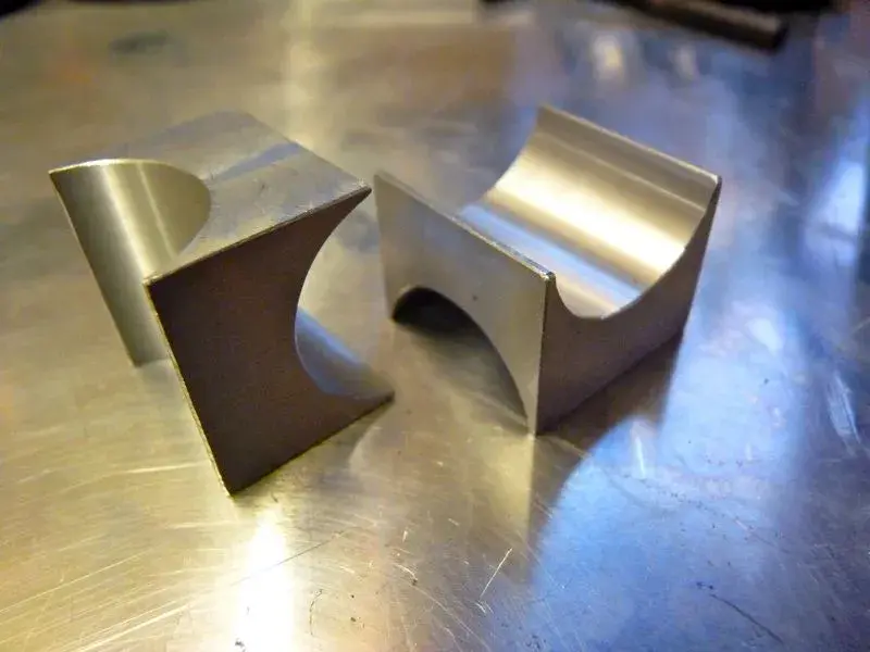

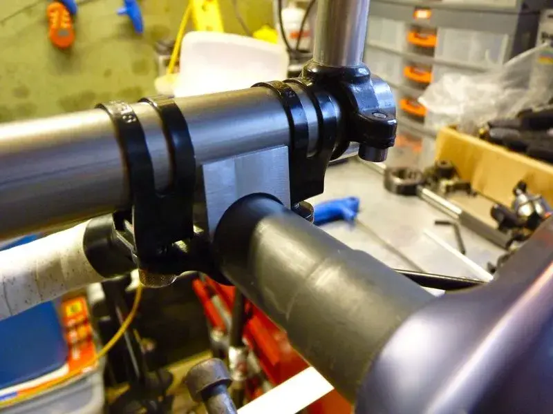

finally got some spacers sorted, Cliff at Royce made them for me, he is such a superstar. these simple spacers enable me to use the mavic profile bars which mean this bike is pretty much all retro :D
i still want to get a nicer post and a better stem, preferably mavic and also a mavic headset.
