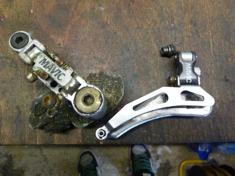

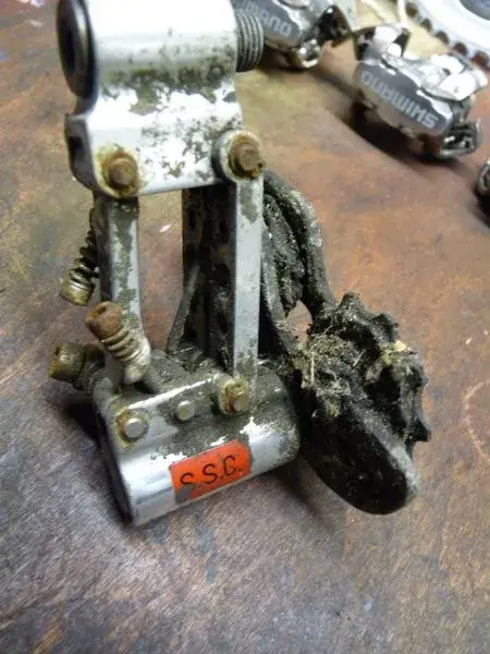

so, a little more of an update on this project. :D
i nipped into my old shop, looked at the pile of crap at the back of the shop outside, found a mavic mech!! covered in crap though!! :lol: Gary then gave me some catalogues to identify stuff with aswel, which i will try to scan later.
i also found a front mech on ebay which i got for a much more sensible price by auction as opposed to buy it now although it was french ebay so maybe they go cheaper over there.
also got some handlebars.
so the accumulation of parts is going reasonably well :D

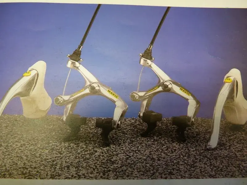

also have decided on the brakes i want, i like the modolo made versions.
8)
Those brake look lovely, jut don't expect em to stop you :-)
From memory i have a set of those brakes tucked away somewhere, calipers
vgc with genuine NOS levers and branded mavic cables from memory... :-)
Andy
want to sell them? :D my mate had the same brakes years ago on his Moser, badged as new success and they seemed to stop fine, maybe it depends on the rim you run them on? when i built one of my mtb's i used a set of wheels with FIR rims and the brakes were terrible but when i switched them out for mavic the brakes were fine.
That Mavic mech won't index with anything atall and is at least 10 years older than the frame. It'll just about work with 8 speed with some fettling (I managed to make one work on my old hack bike but it was a nightmare)
