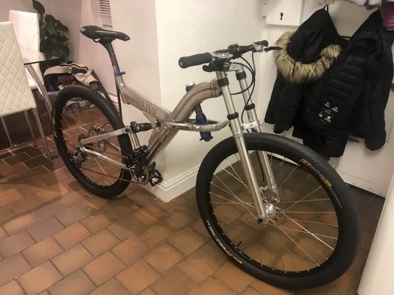

Yes with standard race kings and inner tubes they were coming at 840 grams per wheel,
Now with new set up on 470 grams!
Speed king =426 grams

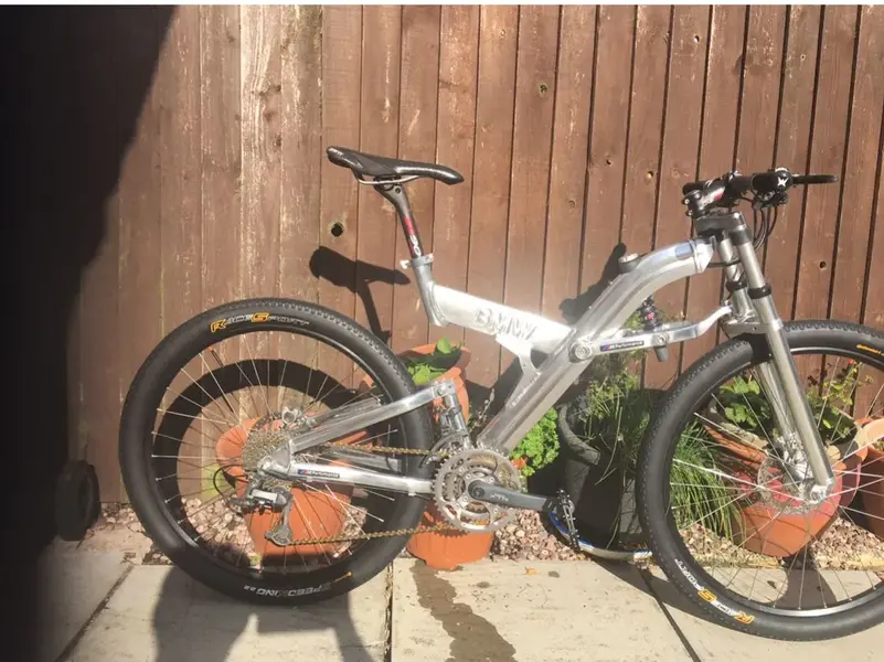

Tubolito s turbo = 42 grams
Well the bike is pretty much finished, all paint stripped and bare alluminium polished, all nuts and bolts replaced to titanium, fox ctd rear, trunnion style front airshock, new light weight rotors, titanium spindles titanium crank bolts , weighing at 11.8kg!!
Wow, where did you get that front airs hock from?
