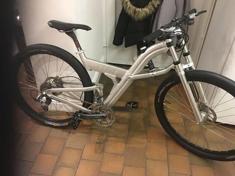

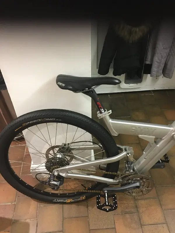

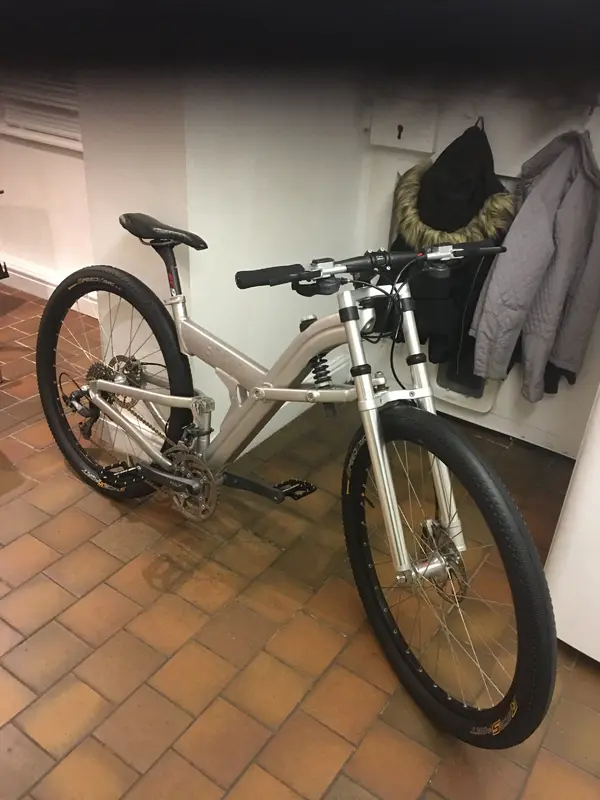

Hi so I got the bug too , never really been into bikes but just loved the design of this beast, so I’ve put gold hollow kmc chain, Ht titanium spindle flat pedals EC90 carbon post , handle bar, stem. Lightweight foam grips , then for ultra weight gone for continental speed king race king tyres with tubolito inner tubes. The weight at the moment is coming in at 12.7kg, just on the hunt for a fox float now which will take final weight to about 12.9kg
I’m also tempted to go one step further and take it back the metal and give it a full mirror polish , I think it would look sick!
