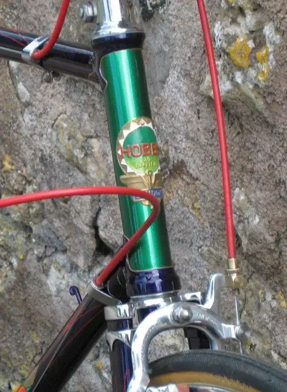

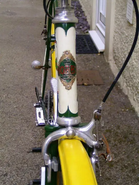

Decal rather than a headbadge; Hobbs headbadges are very rare. I am lucky both my HoBs have the brass and glass enamel headbadges.
Both styles are rare, the Wheatsheaf is super rare (the only one I've seen is this one, owned by a friend).
Jon.

Yes of course - I know you're right, but I use the term 'head badge' very generally to just mean the logo/crest on the head tube!
Looks like a stunning collection of bikes by the way.
