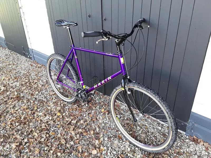

Done several OAP conversions. Bmx bars are ok, but ive found risers like azonic or nitto b802 are really good...not straight.
I've also had made a couple of custom stems, not cheap...but cheaper than a new frame or back surgery !
