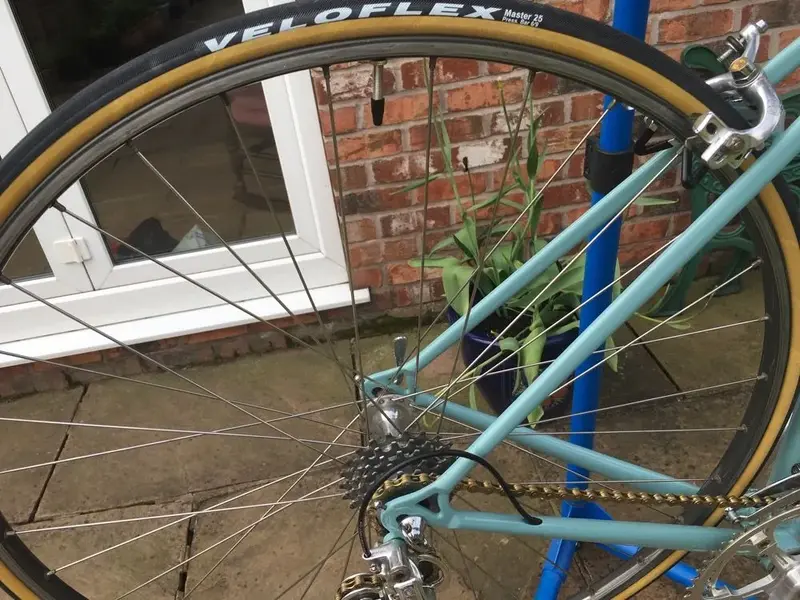

after googling the 126-130 conundrum to death... I've ordered a replacement 10x26 axle from Wheels Manufacturing. 141mm in length and I need 2mm of spacers adding to each side. Hopefully that's a job for the weekend :D
Impressed with the quality of this axle.
It was the right thing to do. I added 2mm of washers to the NDS and just 1mm to the drive side then centred the axle at that. It’s spot on now but I need to fins a longer skewer. The old one is just about long enough but I’d be happier with an extra 4/5 mm

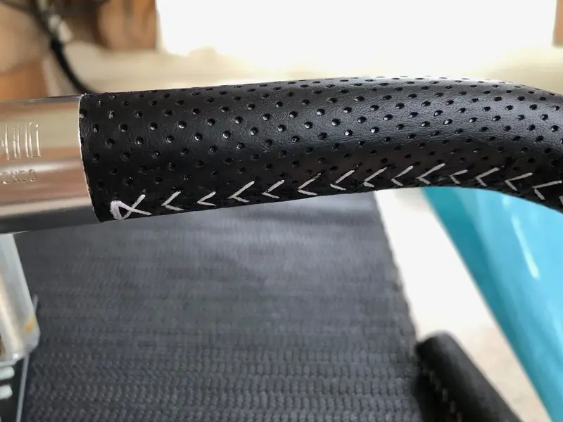

I’m just waiting for the bars to come back. They are at Almarc in Italy being covered in perforated black leather

These finally arrived this week. Almarc bar cover in perforated leather.
