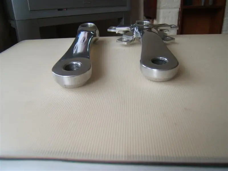

And a few pics :

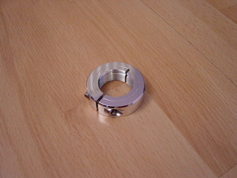

Even the bolt heads don't escape :oops: :lol: :
WD :D
Wow oh wow your a pro, wish you were my next door neighbour be ideal for help. WOW
Time, patience and basic materials ;-)
Honestly nothing more to it - have a go and you will soon find what works for you :D

im currently doing some shot peened cranks :evil:
they are the devil! currently on 120 just to take it bak to flat, nooks and crannies though :evil:
I would say that whatever WD says is the way to go.
Your cranks look to be an easy enough job though.
Any time i've done polishing, i've gone through the various grades of emery and wet and dry, autosol, and finished with polishing soap and a mop used with a hand drill. Sometimes had to start with a file to remove damage.
The polishing soap is reccomended, you can buy them it kits with the mop and a couple of grades of soap.
Good luck, it does take time and patience though.
