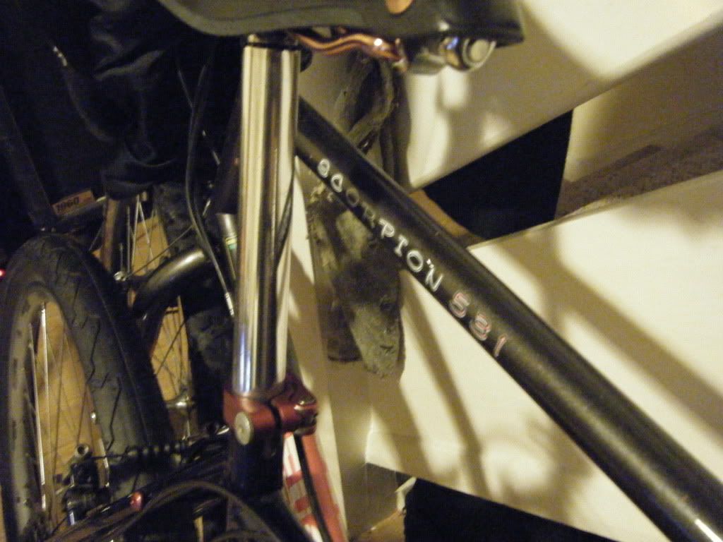

I am using autosol on it but I'm being very careful with it. So I'm hoping it will shine up ok. The seat tube is the worst quite a few scratches and rust spots.
Heres a picture
This one's got surface oxidation that's bad enough that polish probably won't cut through it all before your elbow falls off. 600-1500g wet sanding and a final polish. Use tooth brushes with polish on them on the welds and cable stops and in all the fine nooks on a triple triangle frame.
