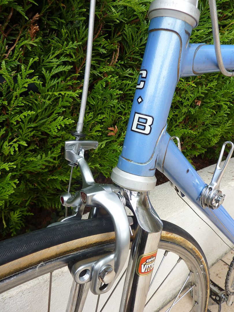

Regarding earlier post,found this pic on flickr
https://www.flickr.com/photos/sfleming/ ... otostream/
Cant see if the actual CLB name is on them,wasnt unusual for products to be licenced around then.
Mavic and Simplex must have had trouble making brakes around that time?
Sean Kelly's Mavic groupset that he used with Skil around '84 and later with KAS had Modolo (Italian?) brakes, but Mavic put their own name on them, as did Renault-elf in '83 with which Lemond won his first world title on, but with a Simplex groupset on otherwise.
Though it may have been Mavic throughout, I dont have a picture to hand and Ive gone down memory lane too far tonight as it is, but from memory Im reasonably sure it was Simplex that year.
You can see the brakes on Kelly's bike in the flickr pic. Look really good too.
Modolo also sold the brakesets under their own name until the late 1980's. (The 'Mavic' brakes that is,not the CLB's)

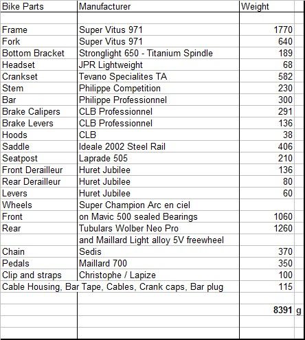

Thanks to Velo-pages, I have found this doc in a Brugelman catalog
it is from a slightly later 82 than this bike , but still interesting as it shows the comparison between, standard parts and light ones and superlight !
worth a read :idea: and pretty much in line with certain of my own measures apart maybe with the rims as mines are Super Champion which weigh about 340 g and you still could find lighter ones at about 300g I believe .
