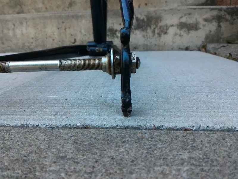

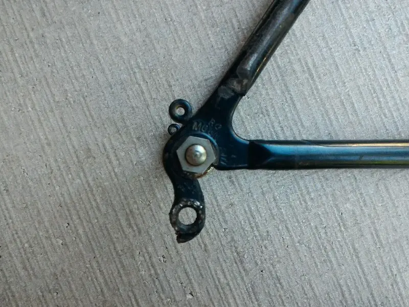

could be wrong but i think i got this back fairly good to where it should! :D
i used a 1500w heat gun to warm it up. placed the hanger in a vice and bent it back as straight as i could vertically up and down. then placed an axle to help with the drop-out spacing. and again heated up and with the hanger in the vice, proceeded to bend the hanger forward to close up the gap.
continued to heat and tweak till i was happy. definitely wasn't one steady motion, as it took a few tries to get to where it is now. hope that was okay, and didn't weaken the steel too much. :?

You could now test the alignment of the hanger by screwing in a shimano axle equipped wheel. If the rims of the rear wheel and the wheel in the dropout are parallel, you can be sure the hanger is "perfectly square"
Been lurking and watching with interest. Top job. Liking the moderate heat. The last one i did with a bit of pipe over the hanger and by eye. :facepalm:
Proper job next time.

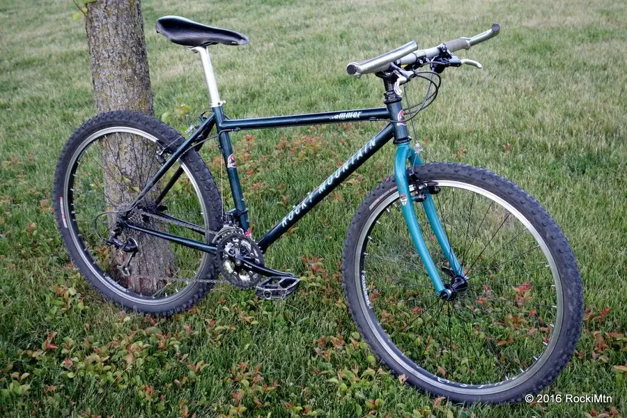

like to report that it's been built up and shifting is all good! :D
thx everyone! ;)
