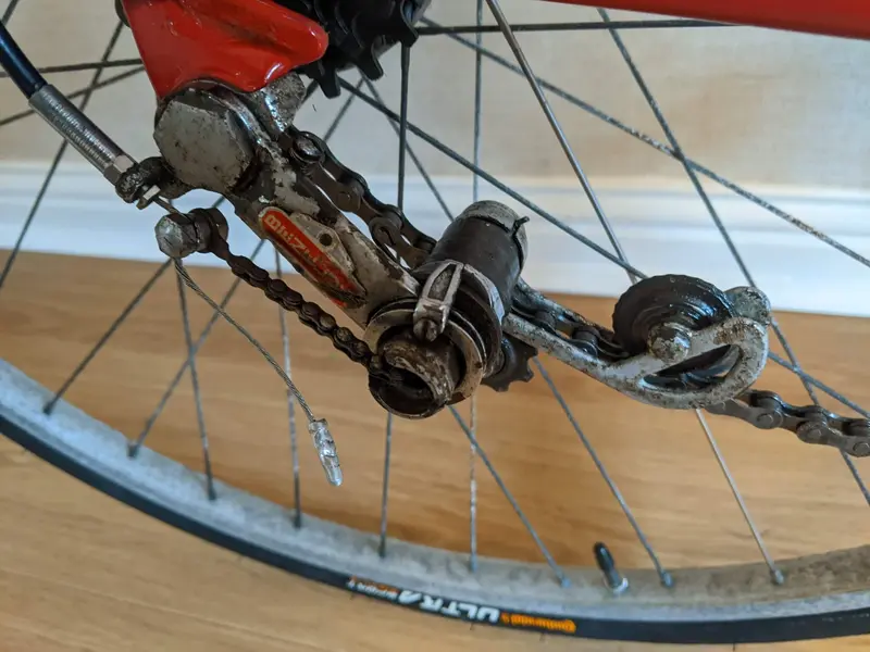

I've been working on the Carlton I picked up from @jfk262 last November and am almost done. However, I've hit one final snag which I can't resolve. The rear derailleur doesn't appear to add tension and, as a result, the chain slips quite a lot and I can only get three of the five gears.
It's a 1955 Carlton running Benelux gearing, I'm unsure of which type but it appears to be 1949-1953 Cyclo Benelux. To say I'm unfamiliar with these would be an understatement. It's been removed, after being coated in gunk, rust and grease for many years, cleaned and re-greased before re-fitting with a new cable outer and inner.

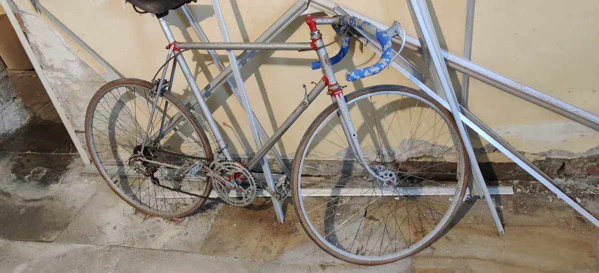

The bike originally as picked up and derailleur looked like this:

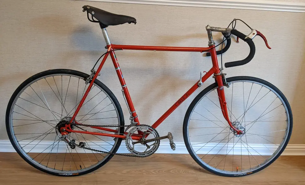

Progress has been made, with the Carlton now looking a bit tidier:
However, the rear derailleur just doesn't shift properly. Current photo of it:
Any suggestions would be gratefully appreciated.
