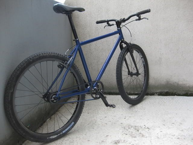

digging an old post as more belts and "chainrings" and "cogs" are available
anyone did try these ?
especially trandforming an old frame so that it can be opened
for example with such a framebuilder kit
or with a neat and smart trick from another schrewd froggie with a "thomson saddle bolt"
to get such a result on a surly frame 8)
With a sturmey or a nexus that would be ace for a "workbike" :idea: ( the rohloff is really too expensive :cry: )
