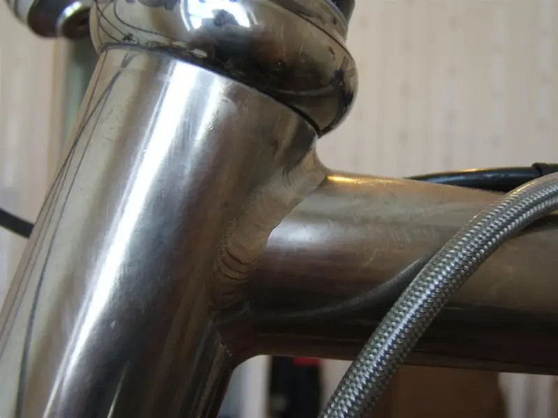

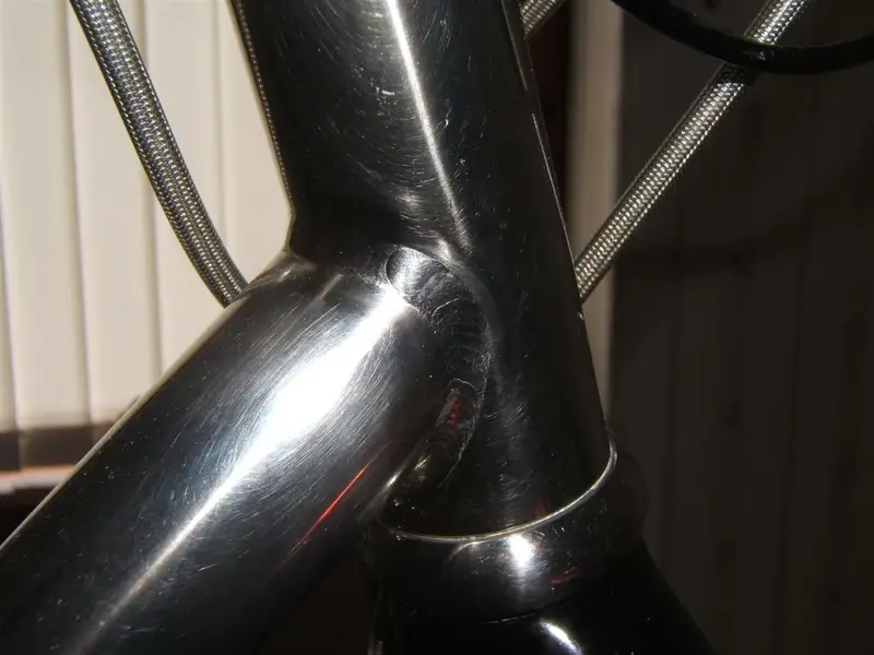

anyroads loving the Ti welds on that merlin- is it the same process albeit they purge the frame with argon to stop impurities?
and more pics please :D

Well I stand corrected! I've been a welder for 20years and never knew that.
Hows mine rate? well not mine but you know :D
edit- Do i really want to show :lol:

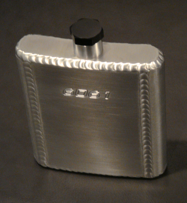

The flask was rubbed down, as I call it with scotchbrite abrasive pads after weld, then degreased with some solvent like acetone or alcohol.

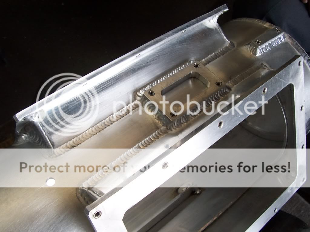

The manifold was tacked, scotchbrite rubbed, degreased, then welded. At the edges you can still see the white etching cloud. John Marcella leaves them that way. I kind of like it too.
Here is an example of mine, with white etching cloud rubbed off with scotchbrite;
[/img]
To keep the distortion to a minimum, look at the direction of the welds. Make a big difference. Most qualified weld procedures have weld mapping.
