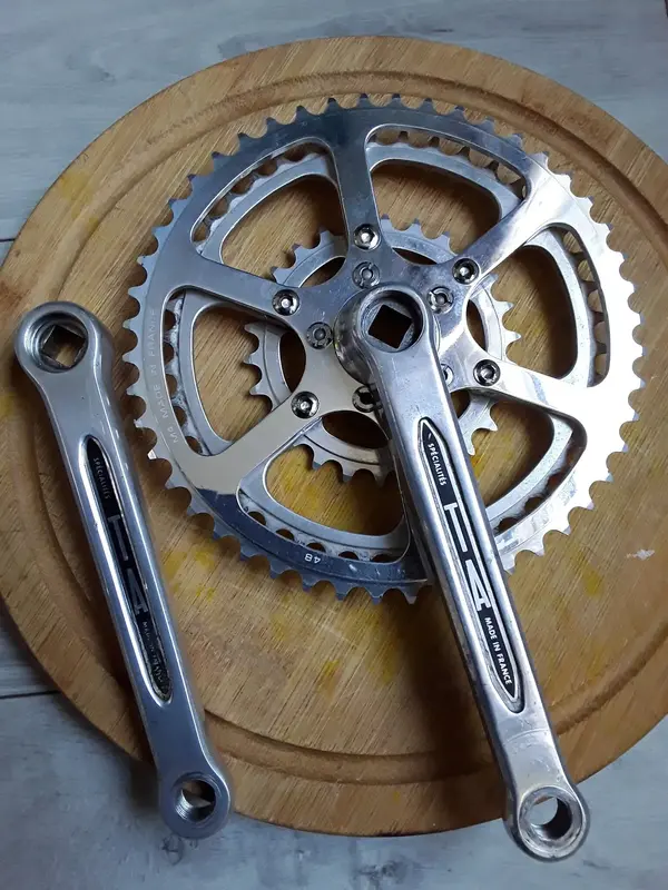

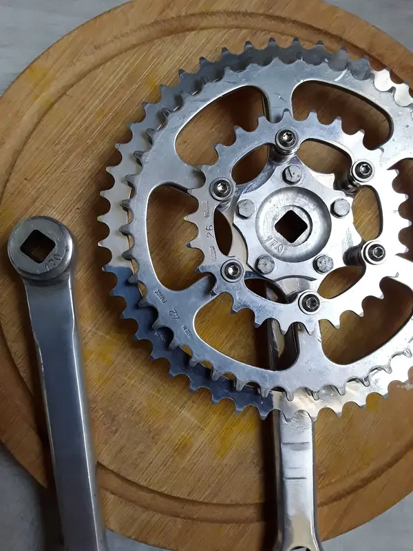

OK, scored a NOS TA BB axle and cups from auction site. It's a 123.5mm which is specific for the Cyclotouriste tripple chainset. I have a spare 118 old Shimano just in case, but I'm pretty sure the TA axle will be the correct width.
Thanks to all above who helped. I must say, the TA stuff is proper quality. Maybe not for mtb's hammering it, but this build (Chas Roberts), is my cross country commuter bike.
