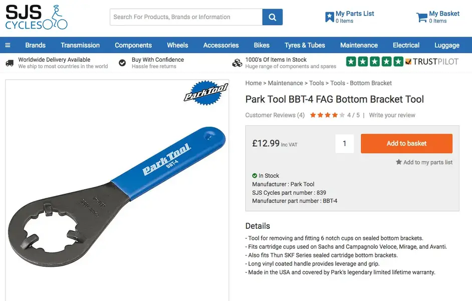

Park Tool BBT-4? It could be same as tool for sealed sq Campagnolo BBs, so good idea with the LBSs - they should have it. Or the tool, is not expensive, just make sure it really fits, I'm not sure.
Thanks both! seems worth saving then, hadn't heard of the brand before....plus i have two frames with this same BB so worth getting a tool, hopefully the ring isn't too knackered.
That BBT-4 looks right:

FAG manufacture top quality bearings for the day job so their BB's are good stuff. I don't think anything from Germany is naff quality? Plenty of proper removal tools out there from about £8 upwards.

If you're lucky a lockring tool will do the job.
If it was tightened with the original tool and now won't budge, you're into a world of hurt with cutting, heat and hammers.
