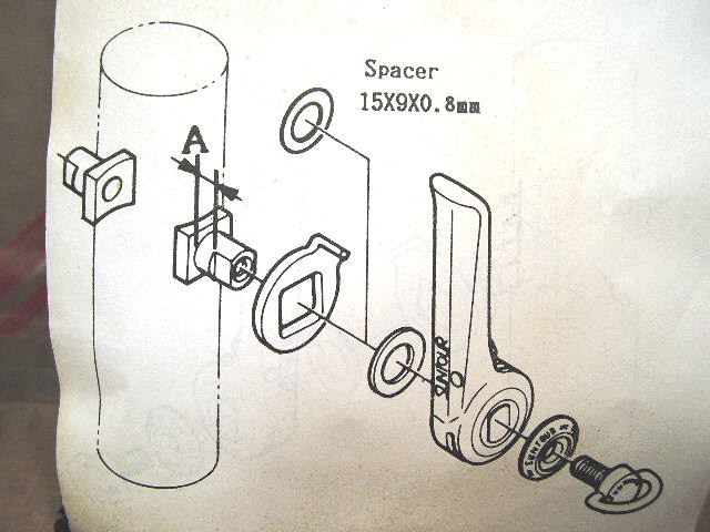

Do you mean the "square" bit that goes first against the frame as below?

Hi Mike, The curved frame spacers on a band on setup have little cut outs to fit around the band so from recollection, you only need to replace these curved spaces
it makes sense that shimano should use the same components for either system,
