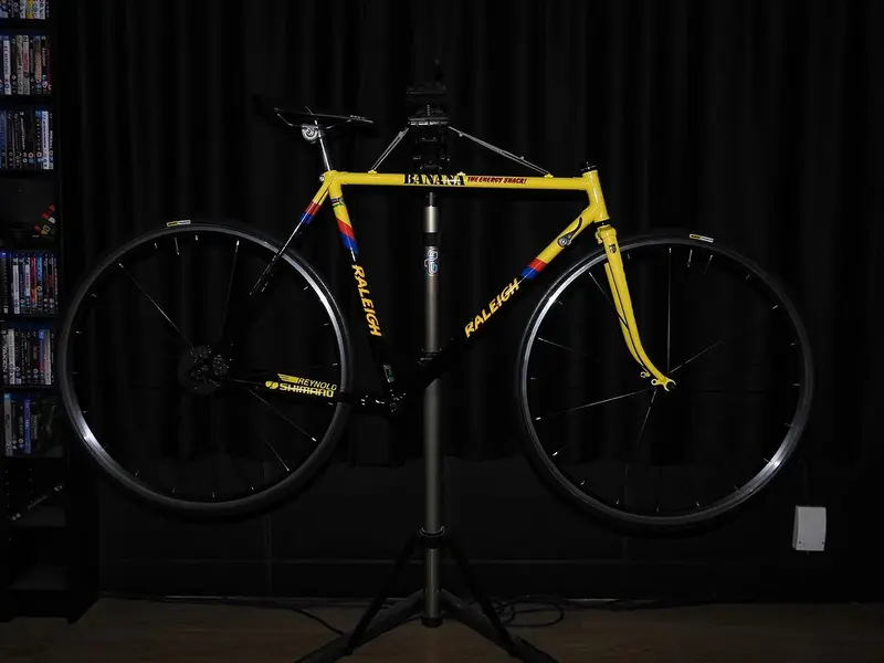

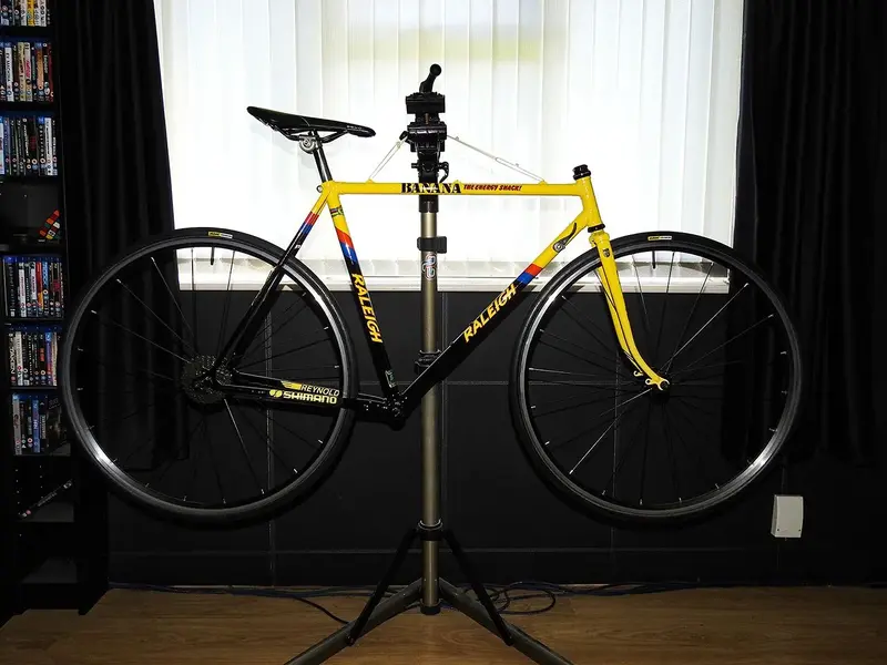

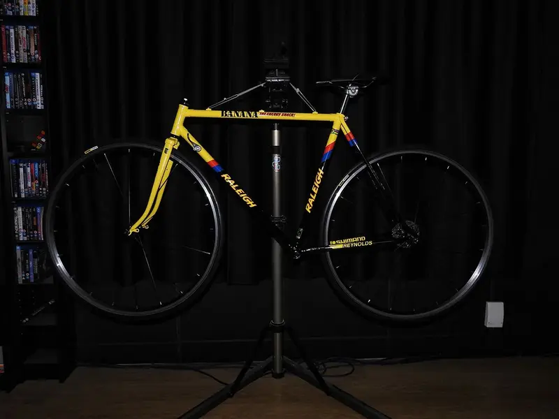

OK two parts to this post, firstly to document what I did to give something back to the community and help anyone like me who watched American Flyers and wanted a retro bike :lol: but whos also struggling to get it running lol, and secondly a question.

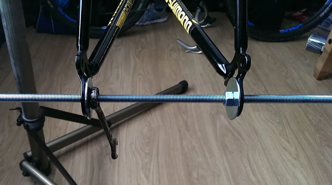

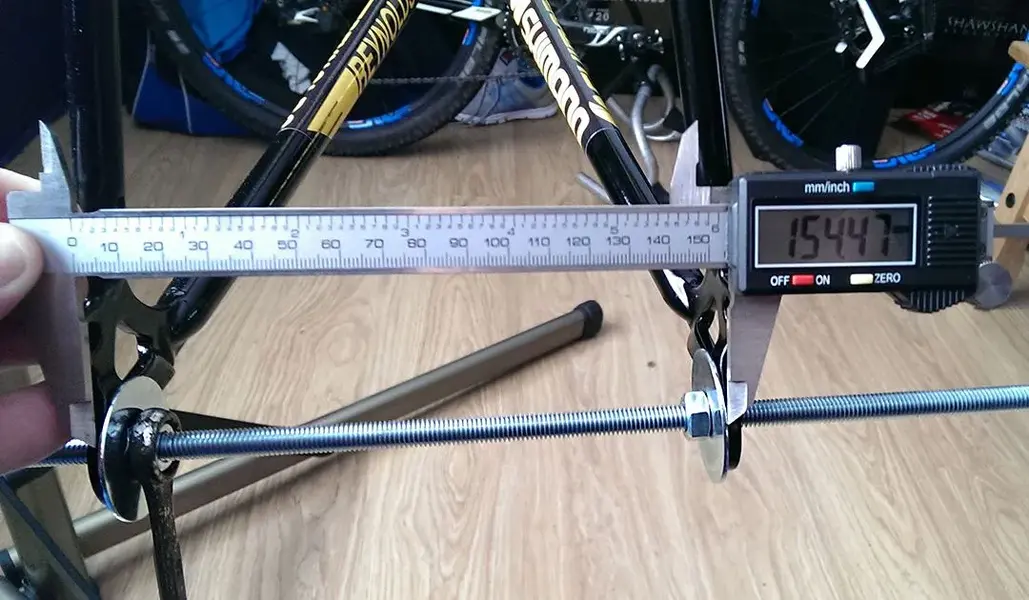

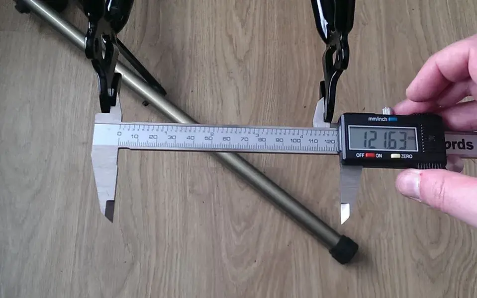

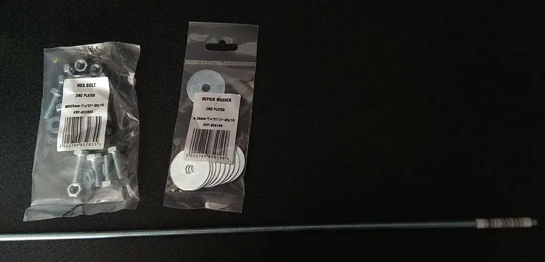

So here is what I did today, the Banana frame would not take my 700c wheel from my Cannondale CAAD 12 so I looked on Youtube saw a video about cold setting and basically stretching the dropouts to accommodate the new wheel.

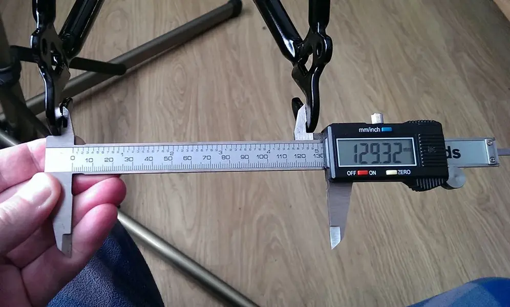

Word of warning, I watch 2 different videos and both these chaps wound out the nuts to 160mm, well when I did the Banana today I only wound out to 154mm and checked and I was already at 132mm! :shock: so I gave it a slight equal press either side, rechecked and it came in at 129.5mm. I tried the wheel and it slid in nice and comfy, perfect 8)
Eres some pics:
So bare that in mind if you want to give this a go, take it slow with small increments and just because someone does it at 160mm wide it doesn't mean this will be the case for you.

Seam welded tubes are far easier to bend than lightweight drawn tubing.
Theoretically you are supposed to bend the ends so that they are parallel, to avoid putting a bending stress on the axle when you tighten the wheel nuts or QR.
