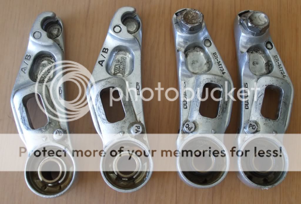

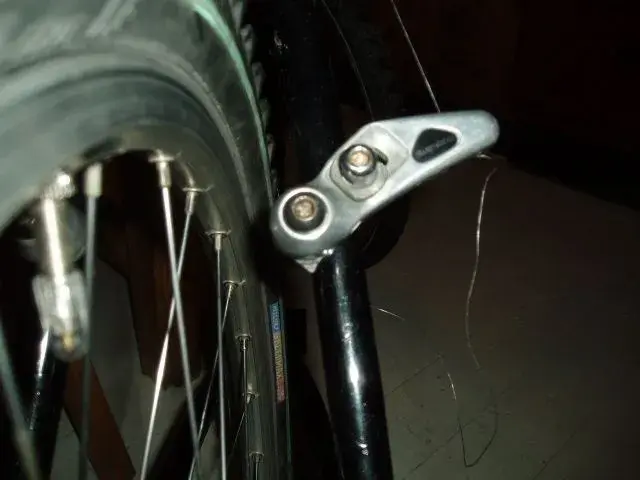

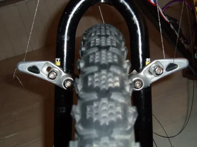

When fitted correctly, both canti's should flop down either side of the wheel at around the 5 and 7 o'clock positions. They should then set up easily from first go.
Neither spring has to be in matching holes - one can be set 'loose' to the opposite so the firmer spring can be slackened off or the grub screw can be used to tighten/ slacken off spring tension.
*and dont forget the two holes inside the cantis themselves.
