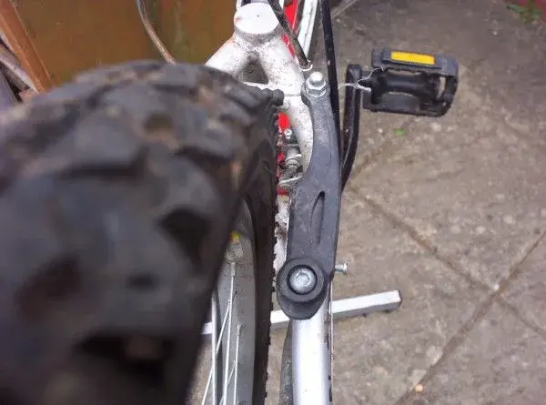

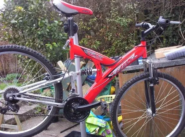

This could be the worst bike to grace this site! I already want to kill it. I can't even get the old cables out of the shifters! Check these out:

I'm currently trying to get working a BSO for a work colleage, though thankfully his doesn't have suspension! They really are hideous though, and yeah, I ditched the gripshifts...

That bike is pretty standard for a £150 BSO, used to sell that sort of stuff by the crate. Unfortunately selling them by the crate wasn't enough to keep the bike shop going even with the repairs that they generated!
