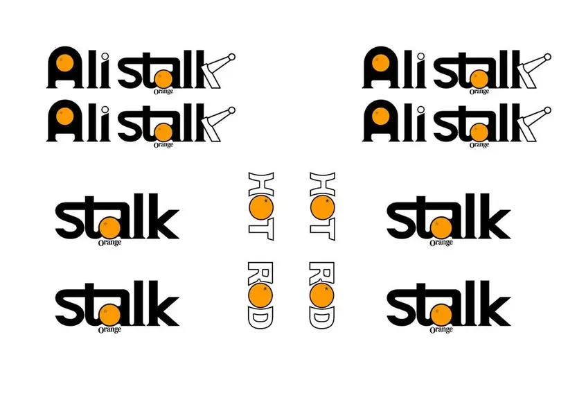

The graphic proof for the alistalk/ stalk / hotrod decals has finally been completed and I have PM'ed gil_m about getting sets of decals made up from these.
Anyone else interested in getting any of these decals made up?
Here's the stem/ bar graphic proof. The 'elite' are on the previous page.

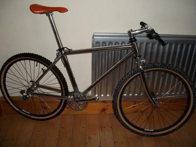

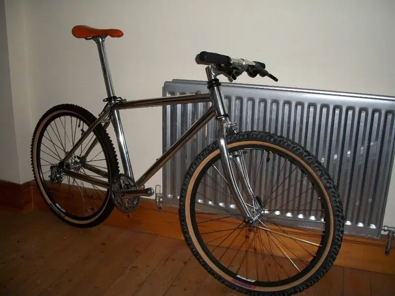

.... been a long time since I've posted any progress on my 'bargin' elite. :oops:

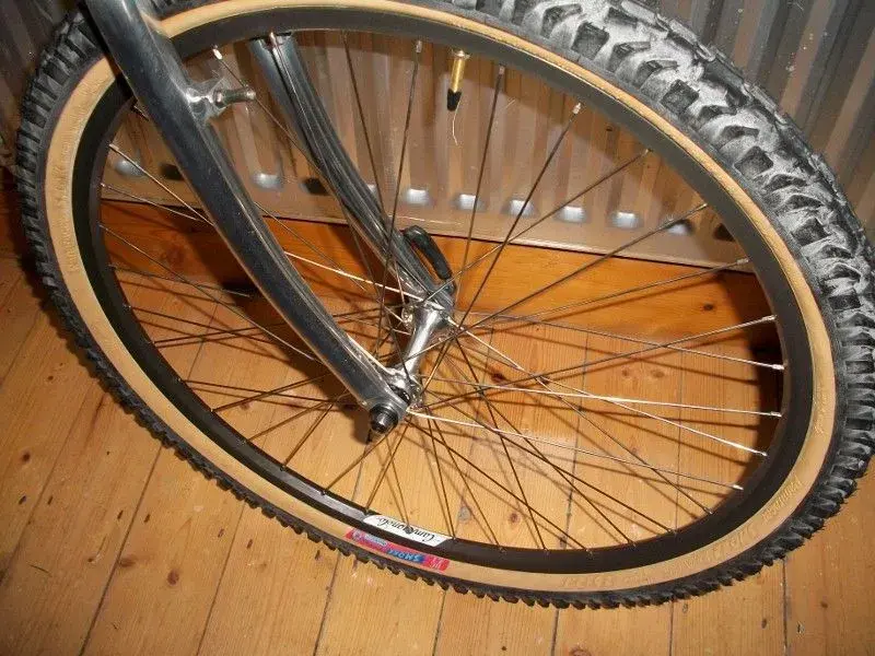

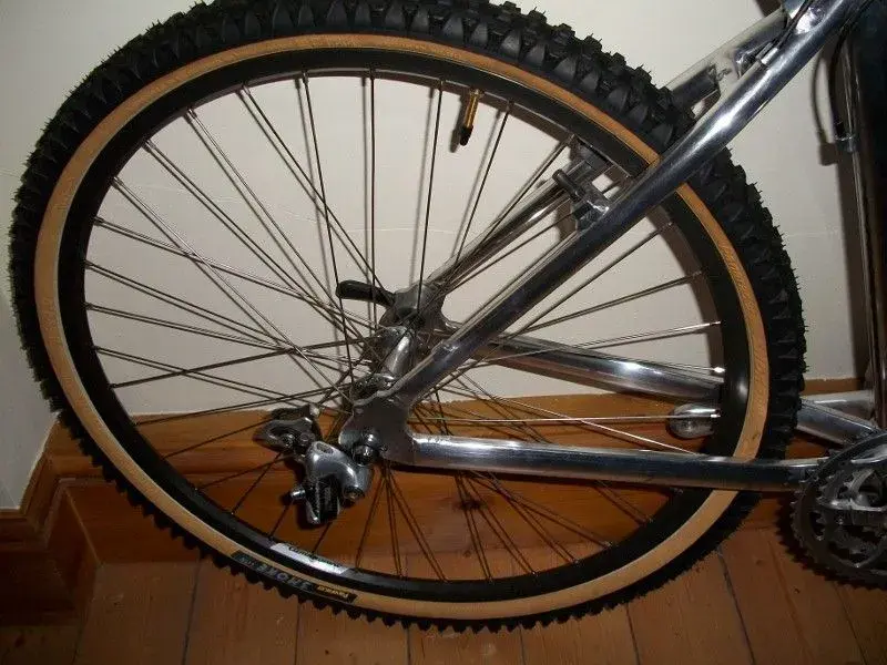

Thanks to RichardC for his time and patience in showing me how to build wheels and daveasmith for the correct 36h hubs, I now have a tasty set of M732XT hubs on NOS campagnolo Atek 36h rims.
There's no better way of understanding the 'black art' of wheel building than building a set for yourself from scratch. These were laced '3 cross' using DT swiss spokes. The lengths of the spokes were calculated using the DT swiss 'spoke calculator'.
The wheels have the correct rubber handled skewers and are shod in a NOS smoke/dart combo.
The Syncros post (31.6x 425mm) was black anodised and was stripped using a dustbin of caustic soda solution and a wire wool/autosol polish.
Reproduction graphics and an orange flite finish it off nicely
The graphics are ready to go on sometime in the next couple of weeks, a little bit of finishing....then I'm done. 8)
BTW... Gil_m now has vector files for the Elite/"O"/stalk graphics. Any one that is after these to complete their 'elite' should PM him for more details.
