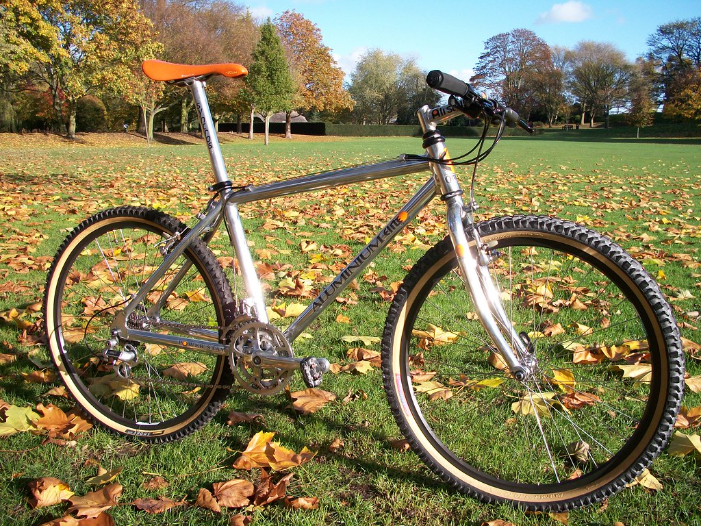

kudos on building your own set of wheels, and all the work you've done on it...polishing is a pain in the ass.
Looks great!!!

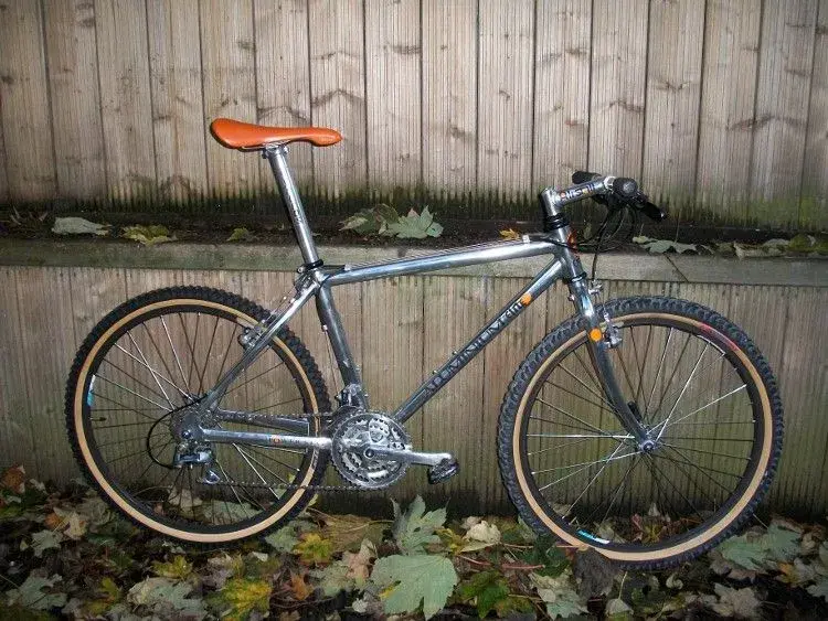

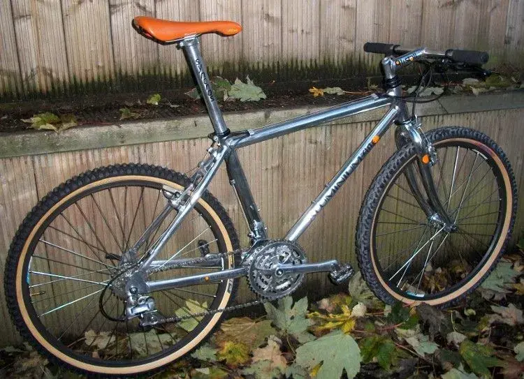

Anyway, my £30 'bargin' elite is now complete!
I drove to Birmingham to collect a 'joblot' of bits that the seller was originally going to skip!!
All parts that are marked with a * were included in the original parts bundle.
Frame*- Orange Aluminium 'elite' 17"
Hand polished with reproduction graphics
( Huge thanks to AndyW and Gil_m for his patience)
Fork - Orange Aluminium rigid. 1 1/4" steerer
Headset - NOS Shimano XT
Stem* - Orange 'Alistalk' 1 1/4" reproduction graphics
Handlebar*- Orange Hotrod- reproduction graphics
Grips - NOS Ritchey WCS
Barends- No
Brakes* - M734 XT Cantilever
Brake Pads* - Aztec
Cantilever cable hanger- NOS suntour front / XT rear
Shifters/ brakes*- Shimano XT STi
Front Derailleur- M735 XT 34.9mm 'top pull' (thanks to Christiankay)
Rear Derailleur*- M735 XT 'shortcage'
Cassette* - 'new' Shimano SG70
Chain- KMC
Crankset*- M732 XT triple. Hand polished
Bottom Bracket*- 'new' Shimano UN54 68x118mm
Pedals- Shimano XT spd
Wheels handbuilt by myself with a huge amount of assistance from RichardC.... cheers!
Hub Skewers- M732XT rubber handle
Rims- NOS Campagnolo ATEK 36h
Hubs- M732 XT 36h (massive thanks to daveasmith! )
Nipples- DT swiss
Spokes- DT swiss double butted
Tyres- Front. NOS Panaracer Dart 2.1
Rear. NOS Panaracer smoke lite 1.9 (thanks to mikeC)
Tubes- Bontrager 'presta'
Saddle- Selle Italia 'flite' titanium ( thanks Jez )
Seatpost- Syncros 31.6x 425mm
Anodising stripped with Caustic soda then hand polished.
Reproduction decals
Seatpost Binder*- X-lite
Weight- approx 23lbs.

stunning well done that man- well thought out and balanced, know some folk won't like the orange flite but I love it 8)

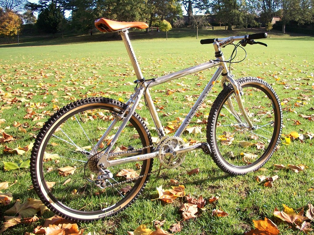

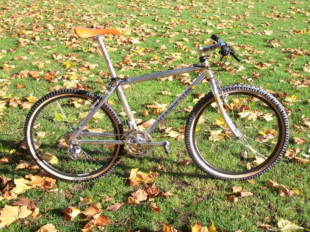

Very shiny and very nice. Congrats!! Question: is it perhaps the angle in the pic but in the side view of the bike, it looks like the fork may have had a collision with a curb? (it looks like it's been bent back - the Orange logo looks like it's about a 1/2 inch too far to the rear). Or is that the geometry of the fork? Again, nice bike.
That's friggin perfect 8) , there's nothing i'd want to change on that if it were mine, the orange Flite and the amberwalls set it right off,
the Alustalk is a bonus too.
Stunning, top job :wink:
