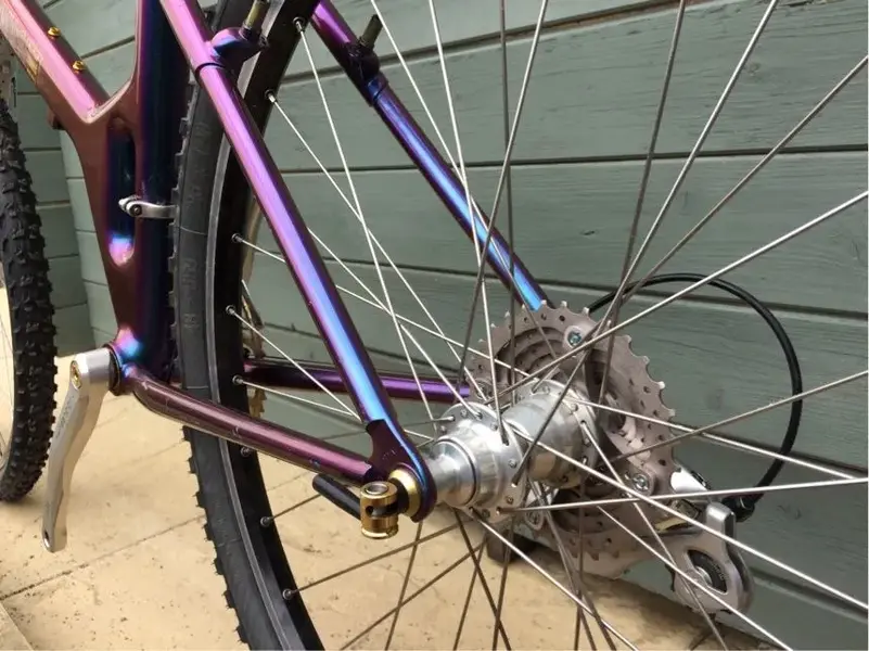

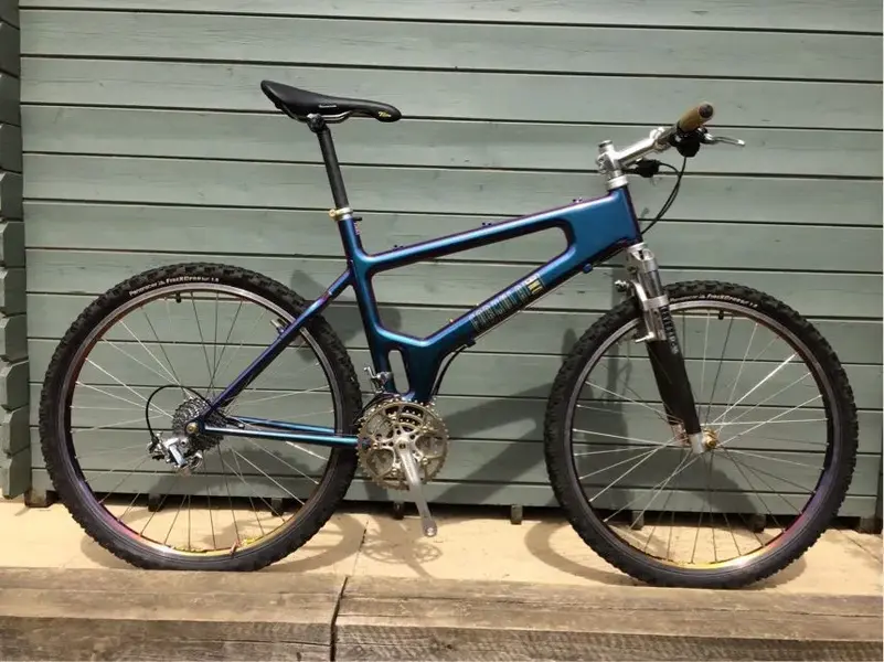

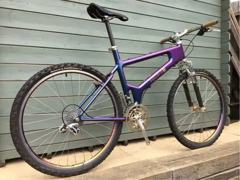

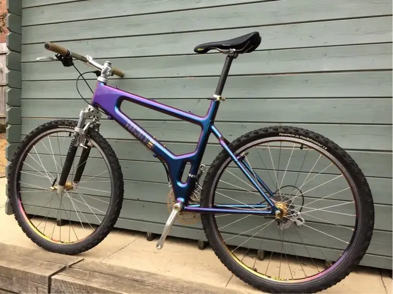

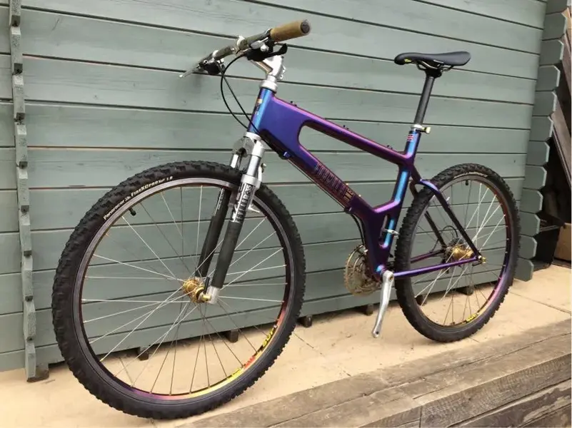

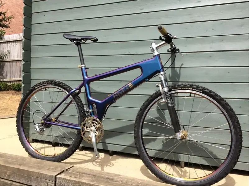

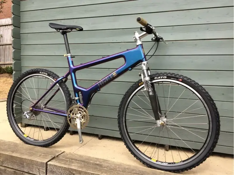

Anyway, here are some more photos with more appropriate, but not final parts......

...and some more pretty shots...

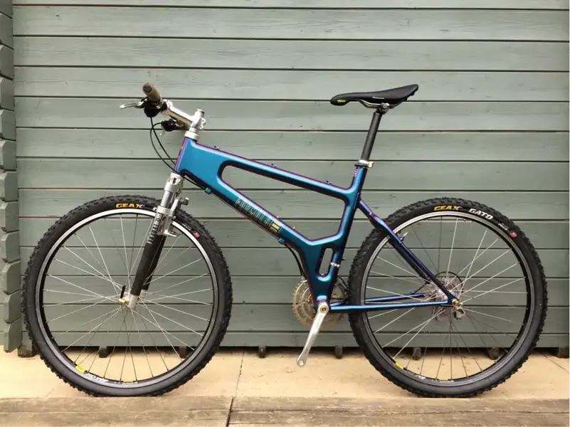

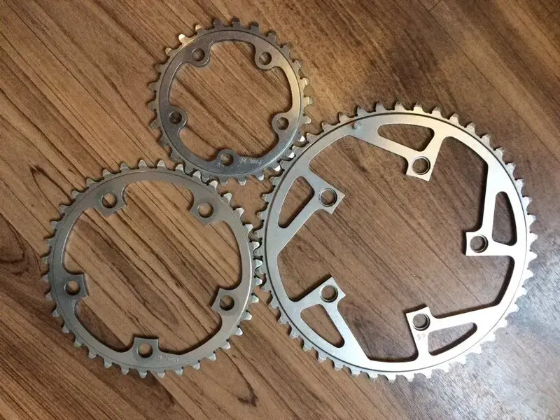

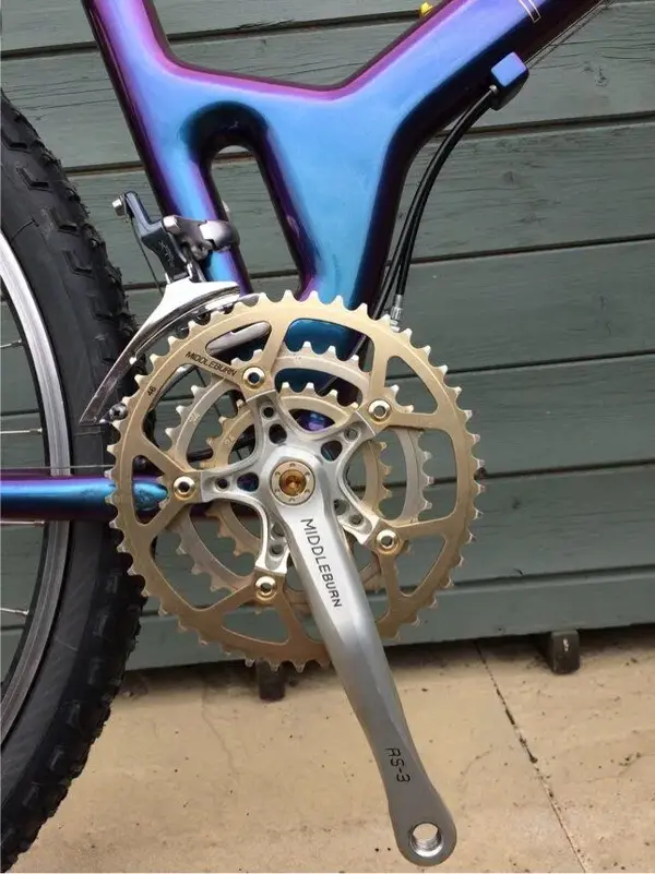

Got some Silver Pace rings which arrived today
Faded pink/purple Middleburn hubs are on it right now, along with a silver Pace stem which is in competition with a soon to arrive X-Lite L168
Looking at the photos just added, I’m erring towards putting the sunset rims back on, albeit on different (British) hubs. I have a blue Goldtec rear which might be a bit new. The Middleburns won’t work as they are 36h and the Hopes on the black XC717’s in the photos are, well, a bit common (and also dibbed by the Bonty Ti)
Maybe the Nuke Proofs in my RC200 F1 post? They are British, right?
Thought / advice?

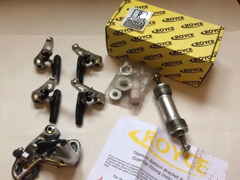

The postie just bought some goodies for this from some awesome fellow RBers
- Royce BB and tool - Veedubba
- XTR M900 brakes and RD - Bikemi60

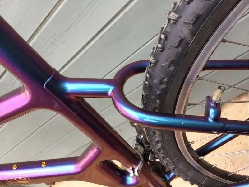

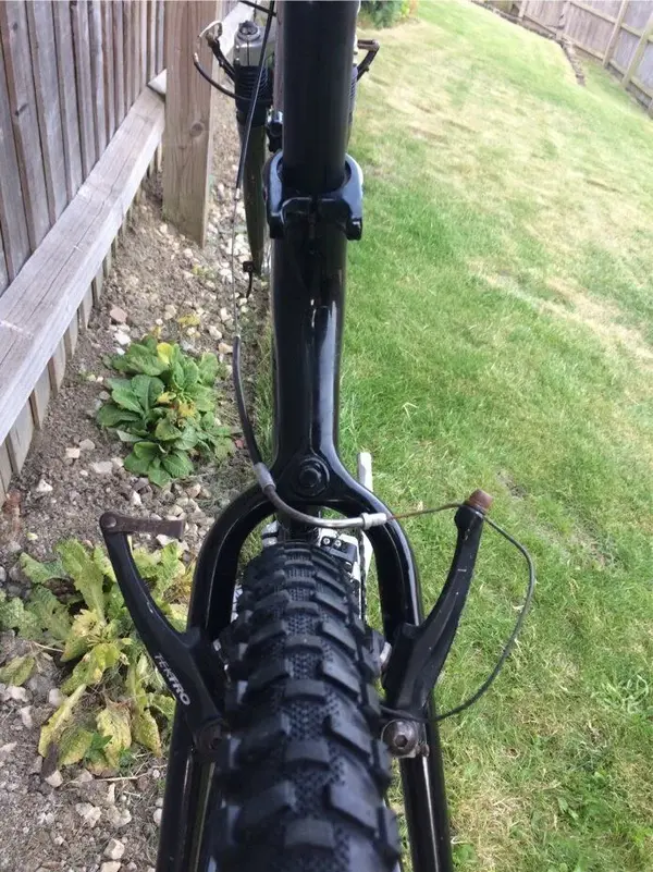

Just to add to some of Carl’s details about the rear end and why it was done in steel and not carbon, it was all to do with mud clearance. As Carl rightly points out, the mud clearance with the Roberts back end is superb and it was only because of the limits of carbon construction back in the day that F1 felt they could not do a carbon rear end that performed the way they wanted it too.

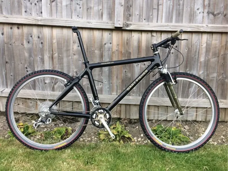

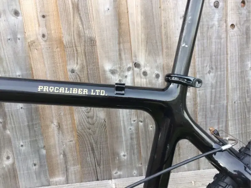

I’m not really sure why as my ‘94 Gary Fisher Pro Caliber which uses the ubiquitous Trek OCLV frame managed all right but there you go, maybe their design or manufacture process allowed them to do something F1 couldn’t.
I guess F1 wanted to keep mud clearance as good as possible, following the Mk1 version with its e-stays. They were unhappy about the lateral flexibility of the e-stay arrangement which is why they reverted to a more conventional rear end with more spaced out anchour points to the mainframe. If I could remember back to my engineering degree, I could probably recall the formula, BD-cubed seems familiar but might be utter bollocks!
