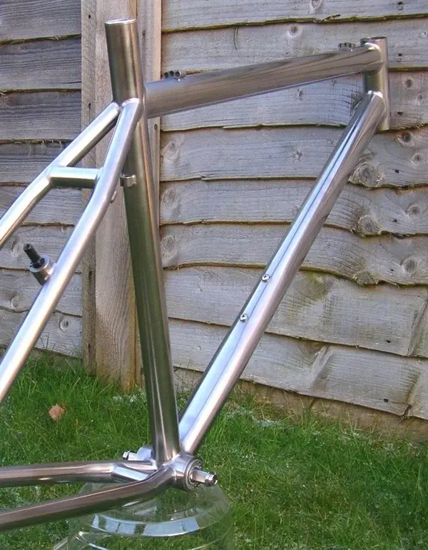

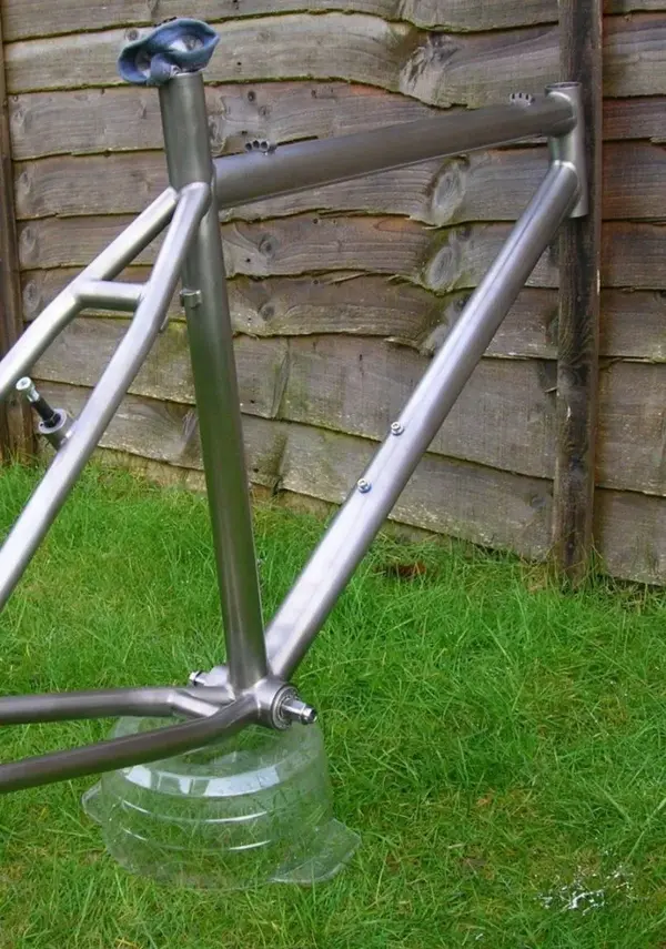

I managed to obtain a reasonable finish with a succession of 3 wire wool grades, then 1,500 Wetordry and finally G3 rubbing compound.
The first picture is after stripping the decals on a '97 King Kahuna.
In the second picture, you can see the reflection of my fence and some of my finger prints on the Downtube.
