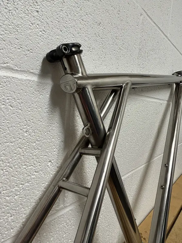

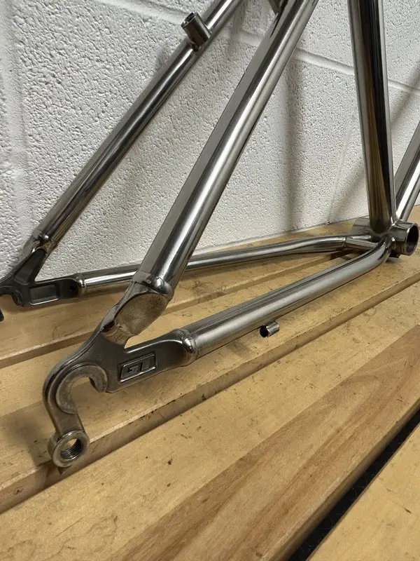

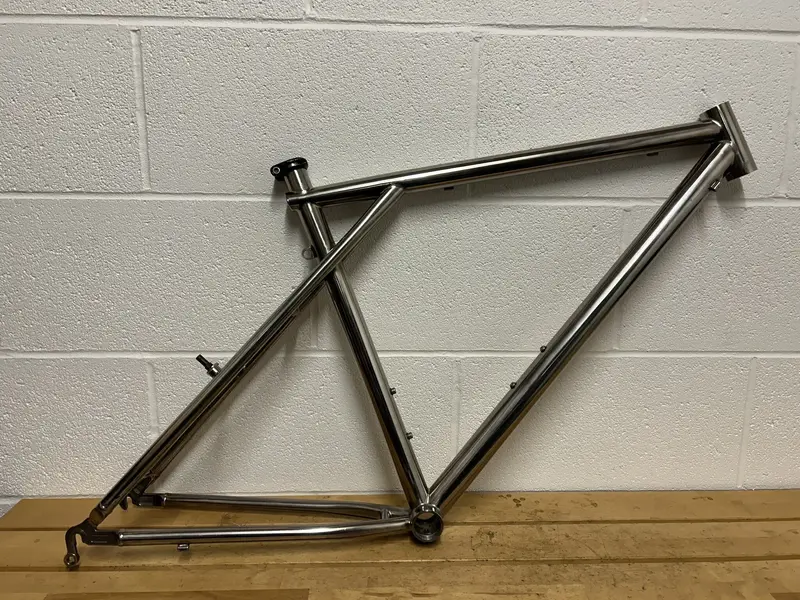

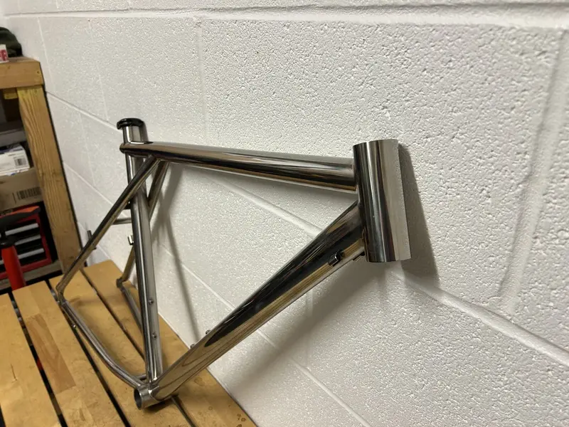

It had a few scratches so i started with a coarse wheel on a drill. This removed most of them and evened out the frame in terms of finish.
Then only a cloth wheel, with a brown paste which gave it an even shine.
Then onto a soft wheel with blue paste to give it a shine
Then finished by hand using mothers.
Likely took about 10 hours (maybe a little more) but I kept not being unhappy with the finish so took a bit longer than it should
