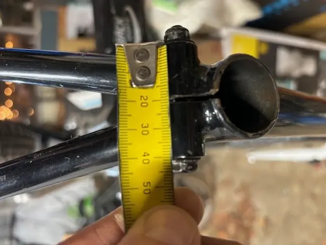

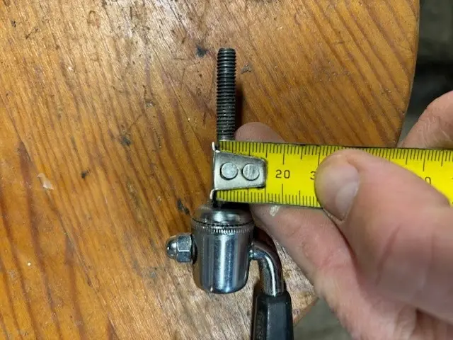

I have a Ritchey Ultra with Tom's classic fastback seat stay design. The frame came sans seatpost quick release and the frame requires a relatively long quick release so none of the period correct ones I've picked up over the years fits. I managed to buy an aftermarket modern version, but it was crap - plasticy, weak and fugly. I'm currently running a bolt and nut, which does the job, but looks terrible too. Wondering if anyone else has had a similar situation and found a nice looking replacement solution. doesn't need to be quick release - it just needs to function and have a bit of that ooh ahhh factor.
Ok, here are some photos of the seat cluster. So from the tape it looks like I need at least 40mm clear on a QR with the nut and washers fastened. The too short DX QR in the first photo fits perfectly and is 5-6mm in diameter.
