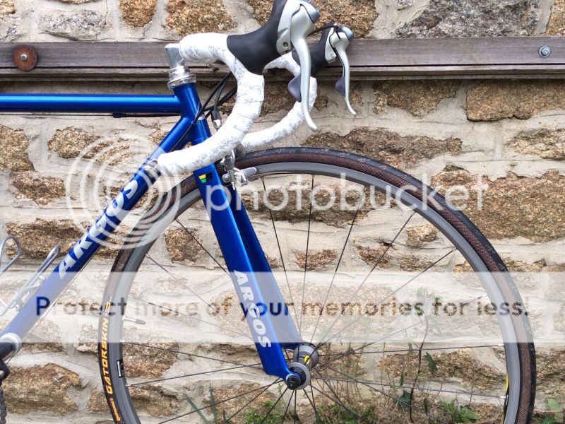

A picture of as it is now:
Aero forks, and awful temporary flower tape!

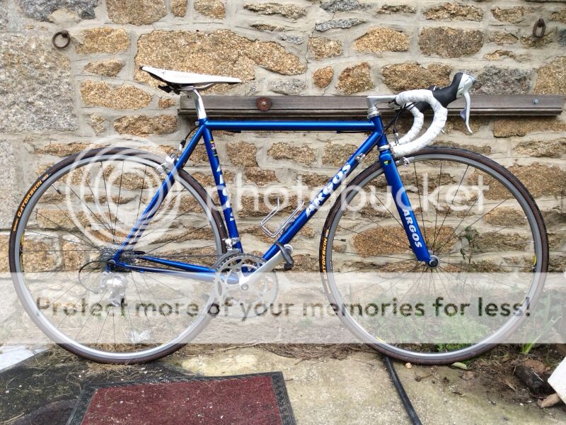

New bits!
Zipp team CSC wheels
Thompson masterpiece inline seatpost
Ultegra 6650 compact cranks (need to colour match the rings, and bolts!)
Fizik handlebar tape
Not far from being where I want it to be, want to get a King TI bottle cage, get some continental GP4000s tyres and polish the black handlebar down to silver, and maybe get some matching pedals.
And maybe slowly upgrade everything to duraace 7800.
Its down to about 8kg, which isn't too bad considering the steel frame and forks.
