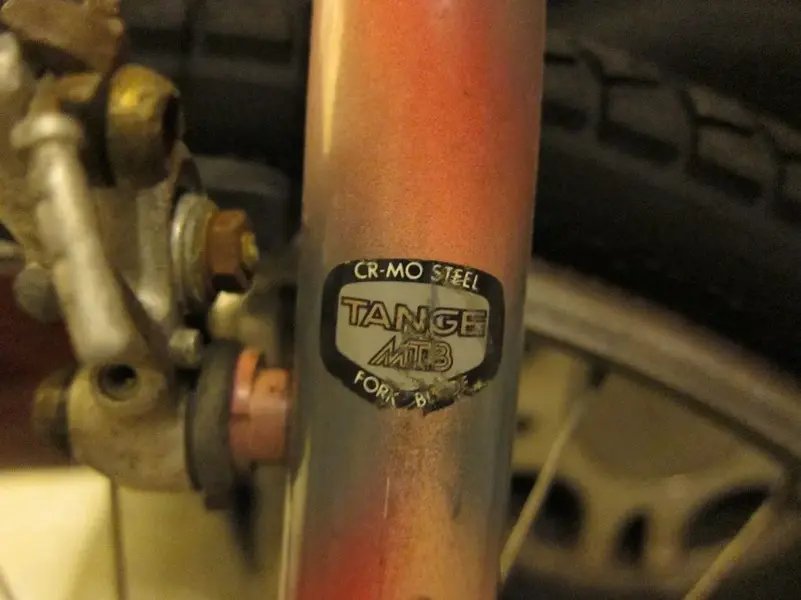

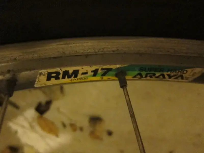

Some more pictures. Check out the frame mounts for a pump... classic!
