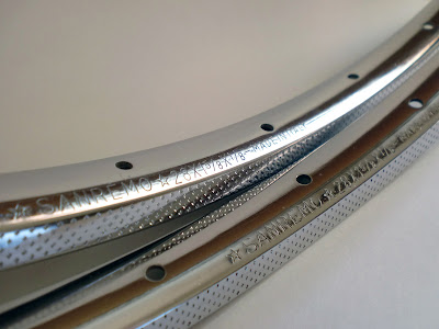

Some steel rims did have a pattern stamped in the braking surface:
However, braking was still pretty awful when compared to an aluminium rim and pretty much non existent in the wet.
