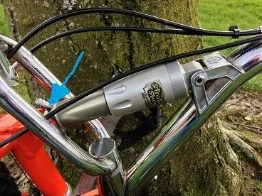

As description says took mine off as rebuilding a orange x1.it still works holds air compresses you can hear the oil in it as well so no leaks.but there is something around inside.are they easy to service and what could the rattling thing be.also how much oil to put back in
Does it have the lock out, or not? No significance to me though.
If it functions ok, i would leave the internals alone as strata don't seem to be operating or have dealer X taking care of them.
I whacked 200-250 pounds of air in mine and, got me the correct setup. As for oil...wind out the schraeder valve assembly and carefully tip the oil towards the valve hole, use a cotton bud to dip or suchlike. If the oil looks red and clean, put it back together.

guys I have the same shock I have taken it apart and need to know how much oil and psi to put in her . any help would be greatly appreciated ohh and I also have rebuilt my x1👌

Sound like you just need less than a ML of oil adding to yours and good to go
thanks for the reply mate. my can is completely empty bro so 1ml of oil? be enough? a lot came out when I emptied it lol I have other shocks there I can use but want keep keep her original ya know
