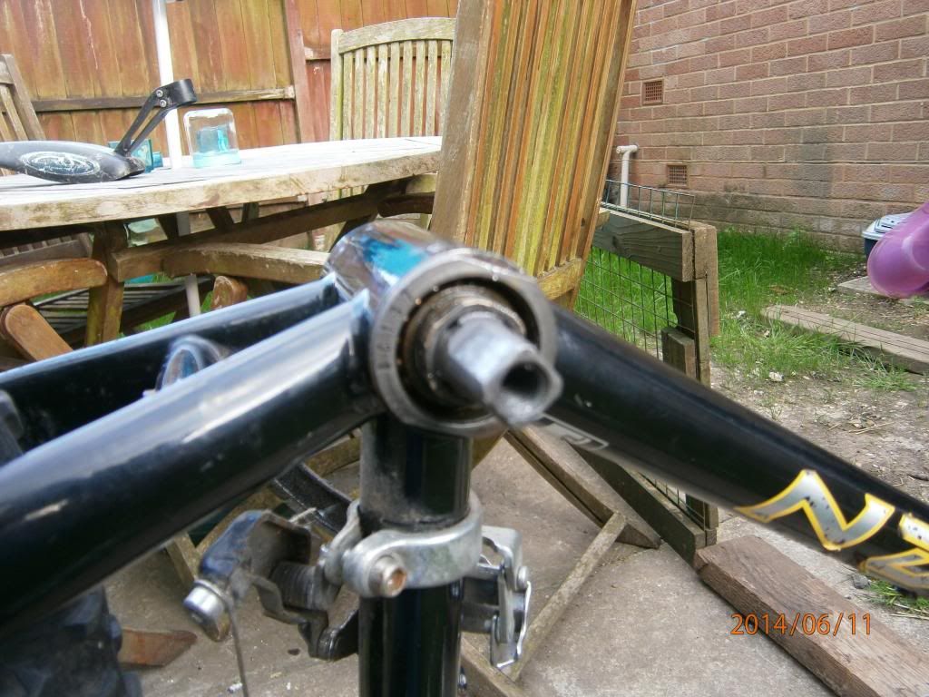

Its the non drive side :?
you say 36mm spanner for the non drive side? usually the 36mm is for the drive side, which is the left handed thread, the non drive side usually needs a pin spanner or a smaller flat spanner, they can be a pig if they haven't been removed for a long time but as suggested a vice can be your saviour in an extreme case. basically remove the wheels, then clamp the cup in the vice and then turn the frame, it's a pain to do but can work.
The drive side had a plastic bottom bracket cup with the splines for the removal tool.
The non drive has this :?
weird, haven't seen that before. have got the tool though. they're usually pretty cheap to buy but i assume it would potentially be a one time use thing.
happy to do it but i wasn't planning on being over your way any time soon :(
