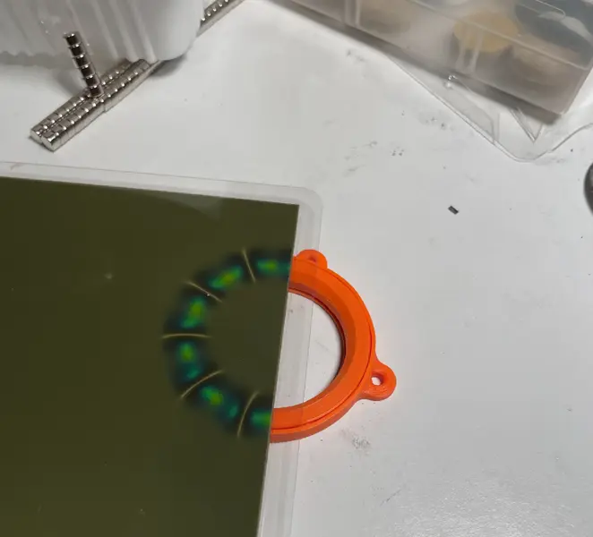

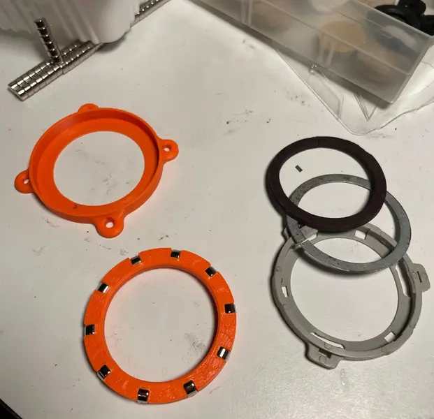

Well, I tried... remagnetizing the original ring seemed to be ineffective, so I designed and 3d printed a new ring with 10 neodymium magnets, opposing each other to try to replicate 20 poles... the magnetic field viewing film shows the original and the new ring.
Unfortunately, it has exactly the same result on the bike... tops out at about 4mph no matter how fast I spin the wheel...
