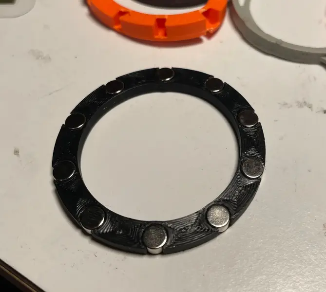

Anyone have details on how the Avocet 30 cyclocomputer magnet ring works?

Final attempt, with new magnet orientation. Absolutely no difference.
I'm coming to the conclusion that the problem was never the magnet ring, but the computer itself.
Calibration doesn't help either, as the range of available wheel diameters is pretty narrow.

I've now spent $12 on batteries, $18 on the magnetic field film, and several hours on CAD and 3D printing :P
It's a hobby, I tell myself.

Do the magnets actuate a mechanical switch like the standard cateye, or are they cleverer than that?
Just wondering if the sensor/ switch is at fault rather than the magnets.
