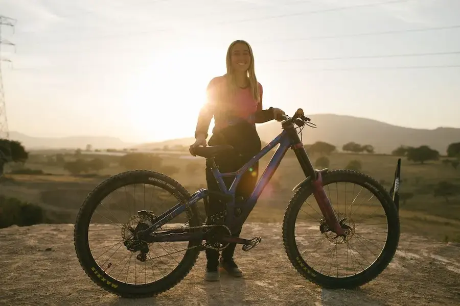

I’ve just re-built a GT Moto 24 for a friend’s 8 year old - it cost 68.00gbp complete and came with 170 travel Manitous on the front (!) - and stripping back all the unecessary gubbins which was on it (a chain device weighing over 2kg, a seatpost made of scaffolding pipe, and a stem made from a lump of tungsten...you get the idea) we managed to get the weight right down and the performance right up. Light short stem installed, with light XC bar cut to match his shoulder width, Shimano Deore and XT brakes installed with reach adjusted carefully for his hands - and really well bled so there’s little movement required on the levers. It has 36 spoke wheels and those could do with coming off. But the rims are wide and have H..U..G..E DMR tyres on - and he loves it. We did Thetford last weekend and I think we can actually use the word ‘shred’ without being stupid. He kept up with us and weren’t going slowly. The big tyres help a lot and after a year or so on 35mm rims myself I am now converted to wide rims and fat tyres.
It’s a bike you can hold up at shoulder height and drop onto tarmac and nothing rattles. Solid and capable, long and low. I photographed the proportions of my 15 year old Grom to his bike (Medium Marley and my medium Sentinel which he nicks) and have set up the GT for the 8 year old with exactly the same wheel, frame, bar-saddle proportions. That’s bigger than we would have done 5 years ago, but it sure works for him. The ‘sitting in the bike not on the bike’ ....see the photo from Pinkbike below. I was impressed with it. And so is he. And it still has the 170 forks on it.
