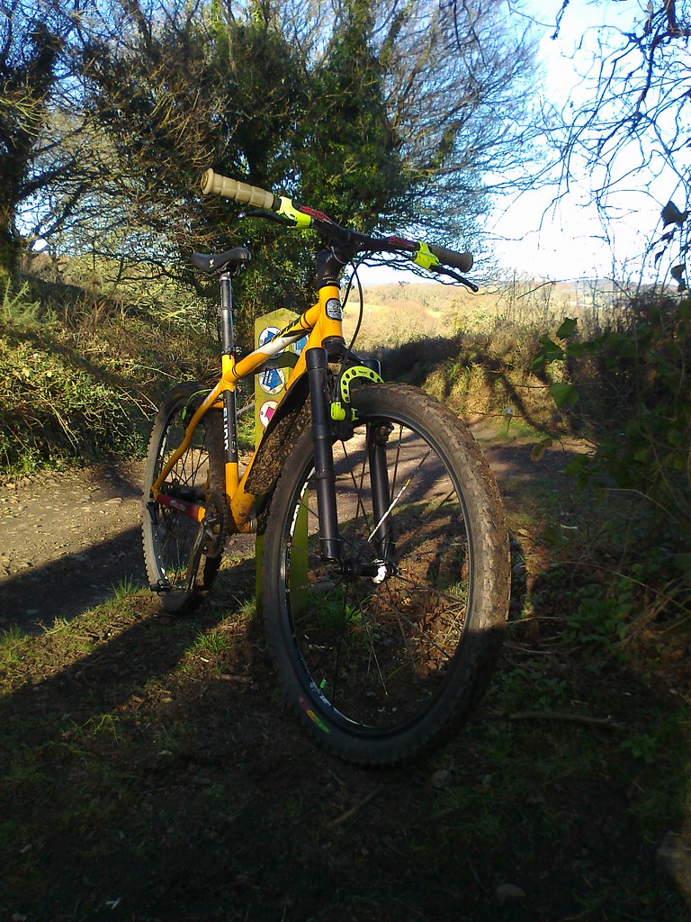

Here's a set on my old Sunn Crosss:
I had one of the first sets of these in the country in 1993 - won from an MTBR competition 8)
The HS33 Racelines with the red adjusters and smaller levers came out in the later 90's.
