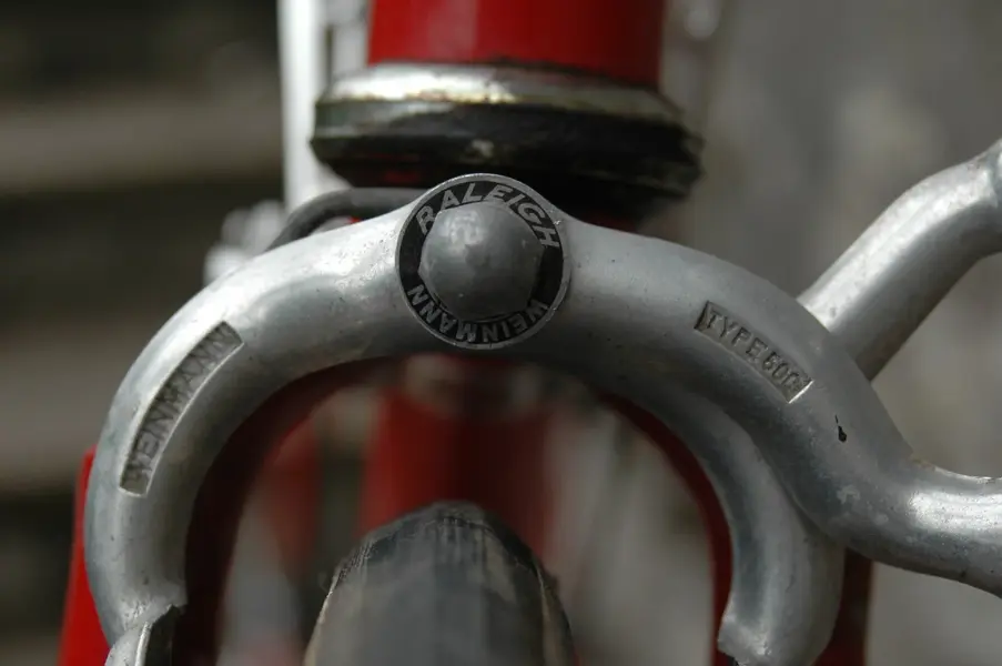

Weinmann side pull brakes, branded Raleigh, with Weinmann levers

Why the big brake clearances? Not sure anyone but the frame builder can answer. They look like long drop brakes
The brakes are normal drops..

and the fork crown is by Cinelli, as used by Barry Chick on Alf Engers' record breaking machine. The tight gaps between tyres and frame were apparently characteristics of many of Alf's bikes, as you can see here;

Could those clearances not be down to it now having 700c wheels in a frame designed for 27”?
No, the wheels would touch the downtube and seat tubes
I'm now thinking it might have been built before campag picolo calipers were launched and the owner wanted to use his existing calipers, today we would see these as long drops, but that was the norm. Look at pictures of merckx et al to see wider brake clearances
