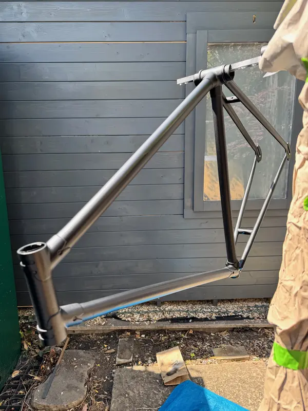

		So, I stripped the paint off over the weekend ( I usually keep what I can of the original paint, but...there was nothing really to keep, it is going to get a respray...). These revealed a few interesting things.
A filled in dent on the top tube, a small hole in one of the chain stays - which I repaired. and some small traces of lilac/mauve paint on the head tube... OK so that wasn't that exciting.
What was confirmed is that this thing is 99% French - measuring the tubes for one thing and the headset is French threaded.
The spacing on the rear is 110mm and on the front and 98mm on the front - to fit the later front hub, someone had just the cones, with no retaining/locking nuts - so am going to have to find a solution for that!

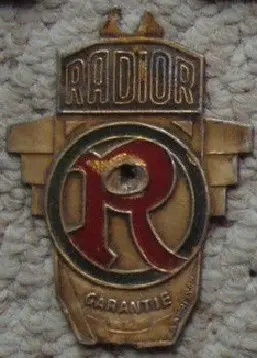

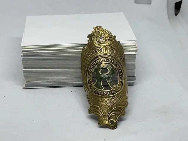

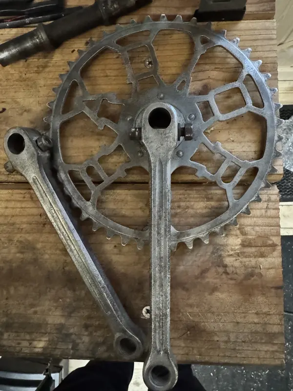

I am going with the Radior - unless I get a better offer Plus - I have managed to track down a Radior chainset in France...
