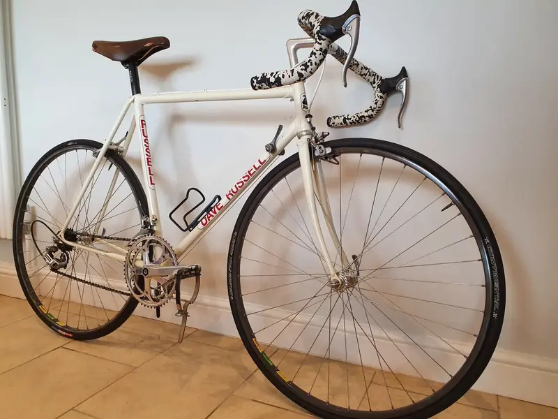

The bike in question is the white Reynolds 753 Dave Russell pictured below. Brought by my dad in 1991 it was resprayed (from an original pink) in 1993 and a new saddle was added, apart from that it is exactly how the previous owner left it. We have always been curious about the age and origin of the bike and have finally pulled our socks up and set out to do some research.
We do know that the frame was built for a Fred Riley who was competing for the National Veteran Road Racing champs, we think in the late seventies. Dad had brought the bike from Fred who had told him the frame had 'criterion' geometry. I've measured it as;
Seat tube (ctc) 53 cm
Top tube (ctc) 55 cm
Head tube 13 cm
Standover 80 cm
Chainstay length 38.5 cm (rough measurements as I presume Dave used inches at the time)
With some tight clearances at both the seat tube and steerer I was thinking it was a racer, but has anyone got any more solid guesses to the intended purpose of this frame??

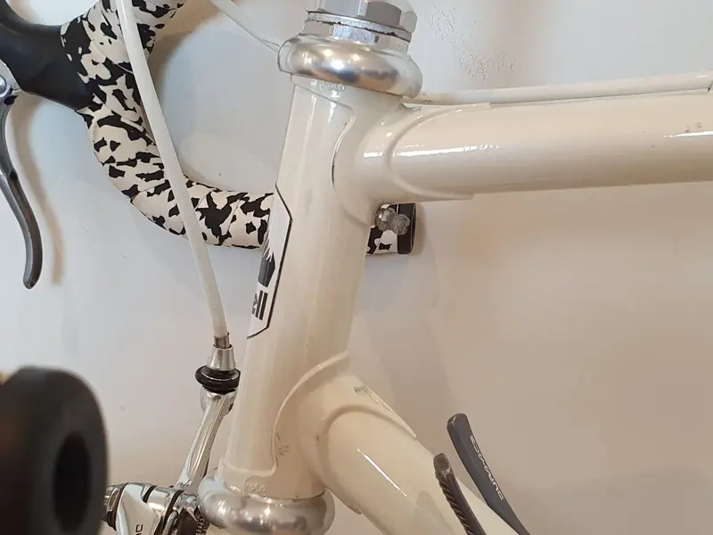

With regards to age, the respray in 1993 has given us trouble. The original transfers were replaced for the ones pictured which, from what I have found, might've been vintage pieces when Dave gave them to my dad personally in '93 as they look different from the transfers Dave was using on his 90s builds. The original Reynolds 753 stickers were also removed. We think the mix of 7400 and 7401 Dura-Ace points to a 1988ish groupset upgrade but are also not sure.

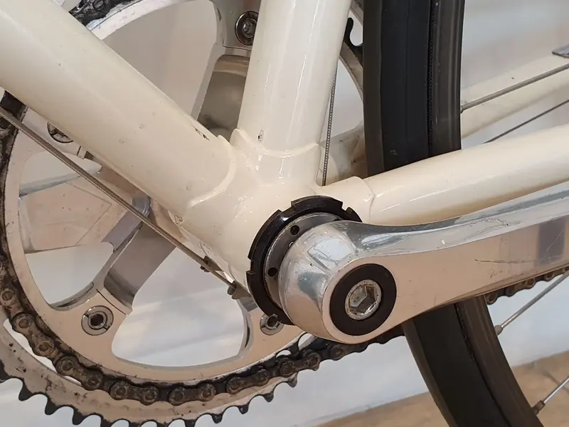

I can't see a serial number on the BB, so I was hoping someone might be able to see features in the frame which might point to its vintage. I know 753 came out in the mid 70s so presume it must be after then but otherwise we are stumped. The only other mark I can see on the frame is a 'Roto' logo on the headtube which I have looked up might point to a prefabricated headtube Dave could have used from the Italian company.

pigman
Nice bike.
The under bracket gear cables, braze on front mech boss and top tube guides point to a typical 80s frame. However, it's possible these were added at the time of the respray.
Also your description of "criterion" frame should probably be "criterium" which is usually a massed start race in a town centre. So it's built for stiffness and fast cornering rather than long days in the saddle

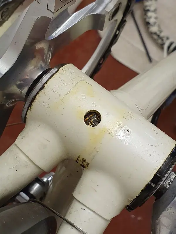

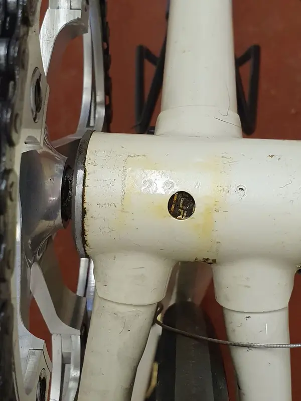

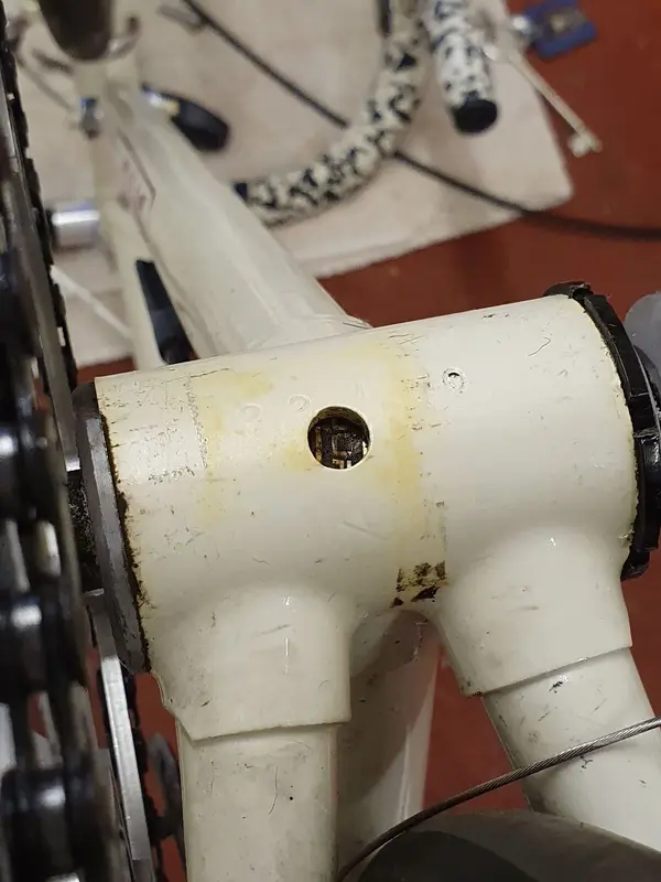

I've taken the cable guide off (Unfortunately don't have the spanners for the headset) and have found the numbers pictured below. The yellow marks look to be discolouration over the years as they don't come off with cleaning.
I can make out a 2 2 4 (possibly 1) 0
With a sideways diamond symbol with the letter O (or D) followed by possibly an L but all I can make out is the bottom of the character, like an underscore _
Any thought on what this might point to? I had thought the first two had worn away over time and was in fact an 8 for '82 but upon closer inspection this does look like a 2.

torqueless
Yeah I thought that bracket looked higher than 10 1/2". The 'EO' in a diamond is the shell manufacturer's trademark. (It is upside down in relation to the frame number.) Looking at the photos, combined with what you've told us of the frame's history, is it possible that the frame number is 22480, ie 1980, and that the eight is illegible and filled with paint?

Great insight once again guys. It would have been great to have some initials in the serial number to try and confirm the suspected original owner of the frame, the aforementioned Fred Riley. I have seen the Classic Lightweights entries, it is great to hear from the owner they are stunning builds!
Cheers torqueless, I am content that an illegible '8' might suggest a 1980 vintage, it certainly fits with the rest of the story. Perhaps I will invest in some proper spanners soon to get the fork out to have a look at the steerer.
In the meantime, I've had a brief look for the 'EO' diamond and there's conflicting opinions in the forums, but will keep hunting.
