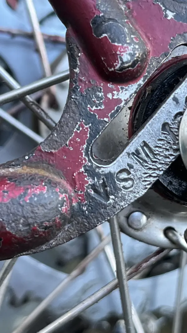

(Pre Raleigh)
If you don’t already know the age, the first letter on Sun and Parkes frame numbers tells you the year it was built. Should be stamped on the dropout.
Thanks
Had forgotten I’d seen that
So, 54/55
Had assumed that was ‘55 ‘season’ but some possibly built year before’.
Saw a suggestion it referred to financial year.

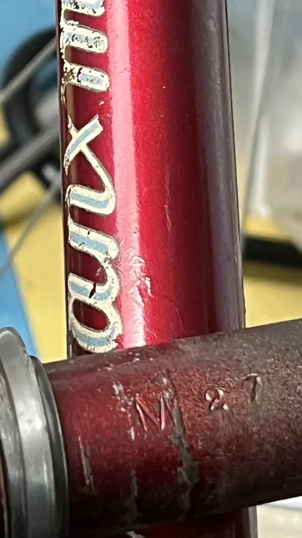

Steerer marked M 27 - presume ‘forks for Manxman, 27 wheels’?
