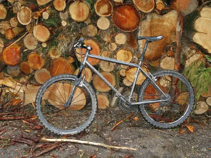

Hey AntsPants - thanks for your DM - don't think I've posted enough to be able to answer! I'm really just looking out for a steel Kona, not too fussed about the vintage although the 90s ones are definitely coolest. I'm 6'2" so a 20" or bigger would be nice.
The pic is my 2000s Explosif with Pace RC39s (so out of the scope of this forum) which was nicked out of the basement of my office in London. Still hurts :cry:
