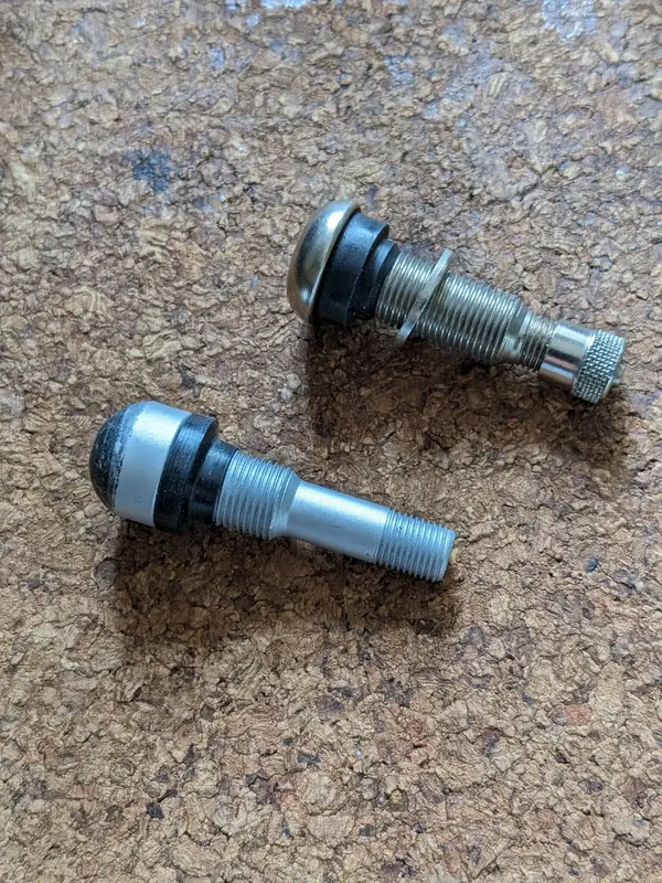

You can obtain screw fit schraeder's as per the pic.
The larger thread measures at 10.1 (SS) & 10.3mm (ALU) OD but same thread.
If in UK could post you an aluminium one if it looks likely - would need cutting down etc.
