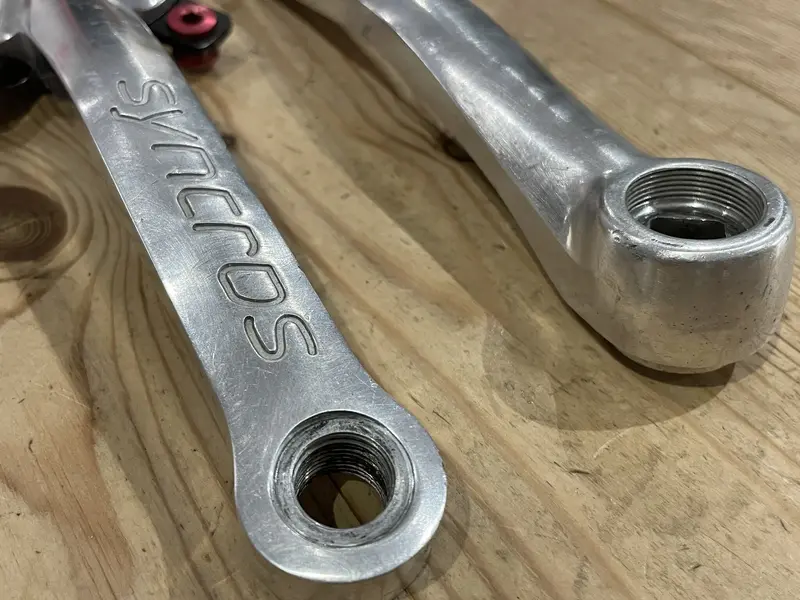

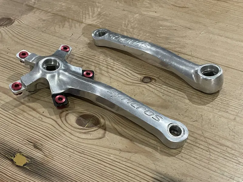

First, they were in really good shape, but clearly loved. Bunch of scratches and nicks to smooth if possible.

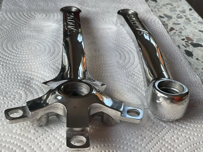

Took them out to the garage and gave them a session on the polishing wheel, following up with hand polishing to get into the tricky parts. Used a toothpick to get all the polish out of the logos / thread recesses etc.

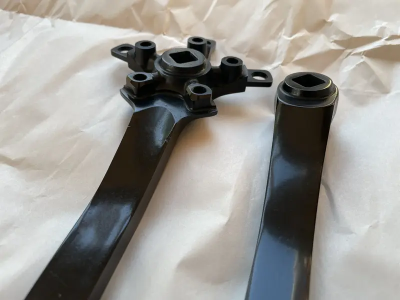

Then sent them off to Steve Barry at Acorn Plating Ltd. (01252 860424 / www.acornplating.com) to get them anodised black. Didn’t need any much prep work so were done the same day they got there. £45 inc postage. Bargain. Totally recommend. Arrived like this…

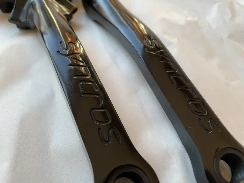

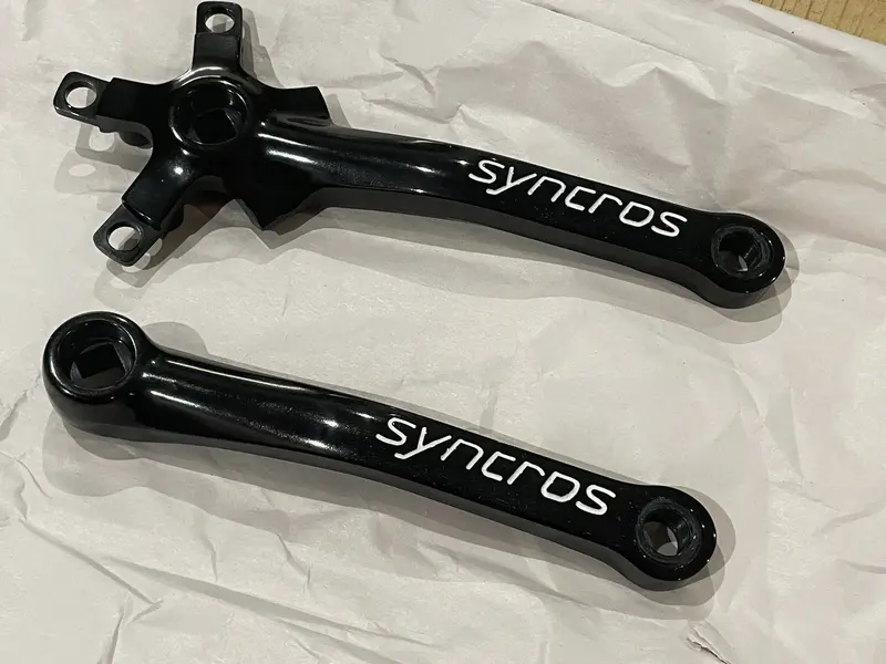

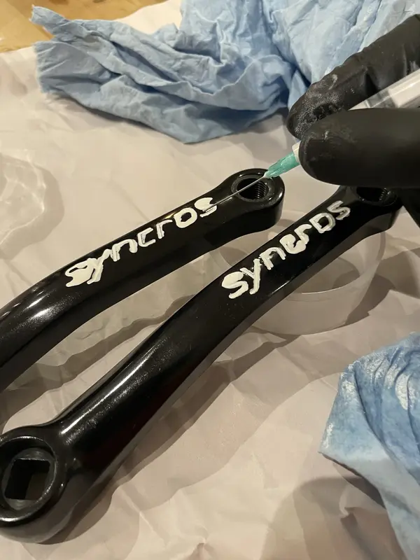

Gave them a quick wipe with isopropyl alcohol to prep them for lettering. Got a rattle can of white enamel, sprayed some into a foil cone (foil around your finger), then used that to liberally add to the engraved lettering. I used a syringe but in hindsight, a finger would have done the job too.
Left it 30-minutes allow to set slightly then gently wiped over the surface with kitchen towel / isopropyl. Turned out great.

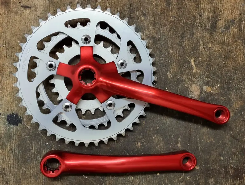

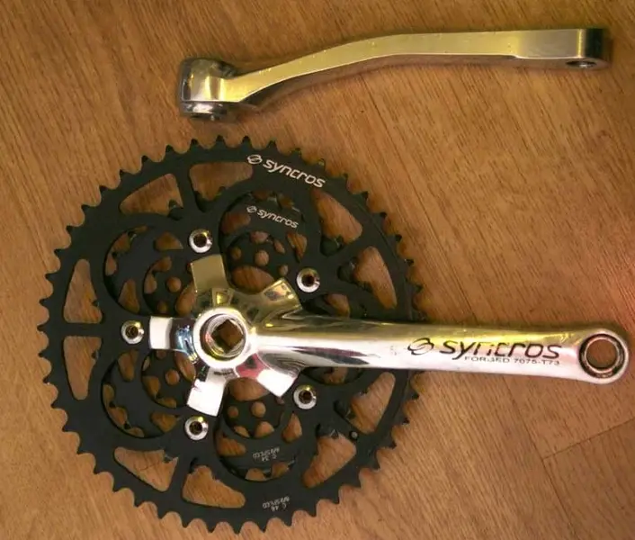

And with rings. If you have a spare black TA Specialities 58 BCD granny ring, lmk!
Just got to build the rest of the bike now!
Hope that’s useful to someone. Main thing is I know a great anodiser now. 👌

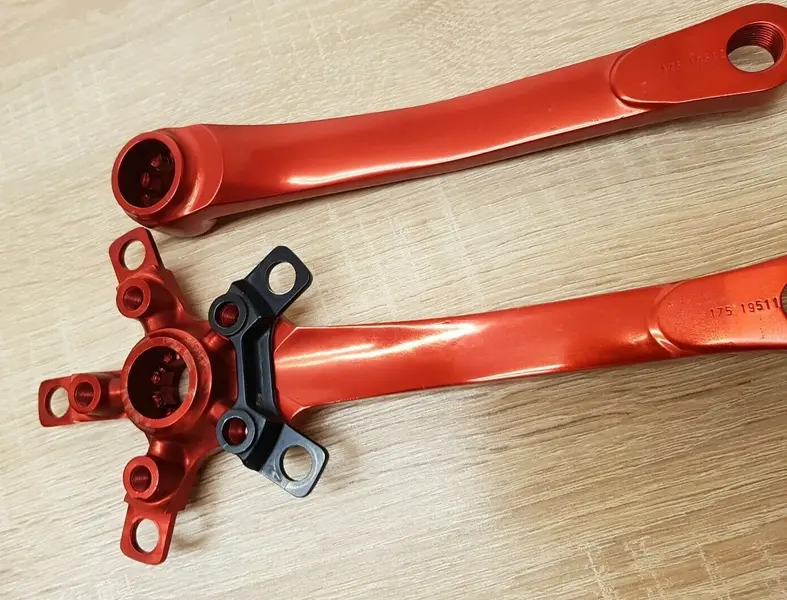

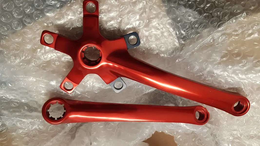

I can show here my anodized Syncros Alu cranks too.
Just can't say anything with regards to how this has been done, because I have bought them already in that way, but the seller told me that the red anodization was done on behalf of him.
Moroever mine are for Octalink (I) bottom bracket, pretty uncommon and have no engraved Logo any longer.
I was told once that Syncros has stopped to engrave, to improve stability, but maybe it was also a cost thing.
Meanwhile I found out there are even two versions printed logos only, one with having the logo located more close the the bottom bracket, like shown in the brochure for 1998
and even some with newer logo with the rings, approx from 2000
