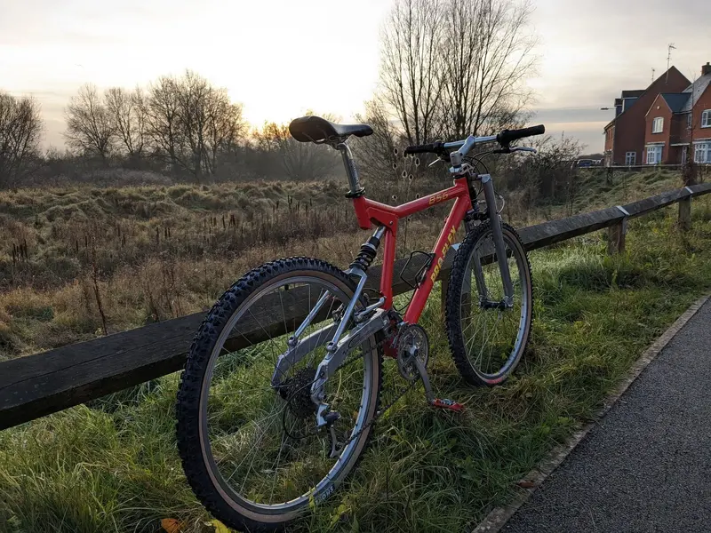

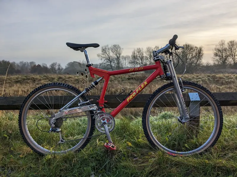

Additional post as the last few weeks have seen the final period-correct upgrades to replace the stand in parts…
Wheels are a set of excellent condition LX Parrallax hubs, w double butted spokes and Mavic 221 rimes – these are in truly excellent condition and were a bit of a bargain. Shout out here to https://www.ebay.co.uk/usr/pennwood_cycles who has a reasonably new eBay presence, but a good mix of off-and on-road part at decent prices and who was a pleasure to deal with.
I went with the traditional Smoke/Dart combo to get the amber wall look. Will have to see how these perform in the mud over this winter and may look to get a set of Nobby Nics (in tanwall if possible) thanks to this interesting thread https://www.retrobike.co.uk/threads/26-tan-amber-wall-tires.452585/ (and others)…
To go along with the flats and SPDs, some red Wellgo double sided options were added to give the option of grabbing it out of the garage whenever the mood or need takes me.
I also shortened the crazy big loop on the rear der – although it looks like it could still lose another inch or two at least…. Perhaps a Rollamajig or similar is called for here?
Hoping to hit some trails / mud over the winter and add some in use pics.
Frame: Proflex 856 (w rear spring)
Fork: Girvin Vector AL (w Fox Float shock)
Headset: M Part Sport threadless
Stem: Proflex
Handlebar: ITM Easton EA50 "E" XC Flat Handlebar
Grips: Gripshift
Barends: none
Brakes: XT M739 V-brakes
Brake Pads: Shimano cartridge
Brake Cables: Clarks
Cantilever cable hangers: N/A
Brake Levers: Diacompe PC3n Diacompe DP-7
Shifters: Gripshift SRT 800 X-ray
Front Derailleur: Shimano LX M556 Shimano XT M737
Rear Derailleur: Shimano XT M739 with Avid Rollamajig
Derailleur Cables: Clarks
Cassette: Shimano HG 8 speed
Chain: Shimano HG 8 speed
Cranks: Sugino Impel 500
Crank Bolts: Sugino Impel 500
Chainrings: Sugino Impel 500
Chainring bolts: Sugino Impel 500
Bottom Bracket: Shimano UN71 cartridge
Pedals: Wellgo platform SPDs
Hub Skewers: Shimano
Rims: Mavic 221 UB
Hubs: Shimano LX M 563 / 565 Parallax
Tyres: Panracer Smoke / Dart folding reissues
Tubes: Butyl
Saddle: Selle Italia Flite Titanium
Seatpost: Ritchey 27.2
Seatpost Binder: Modern
