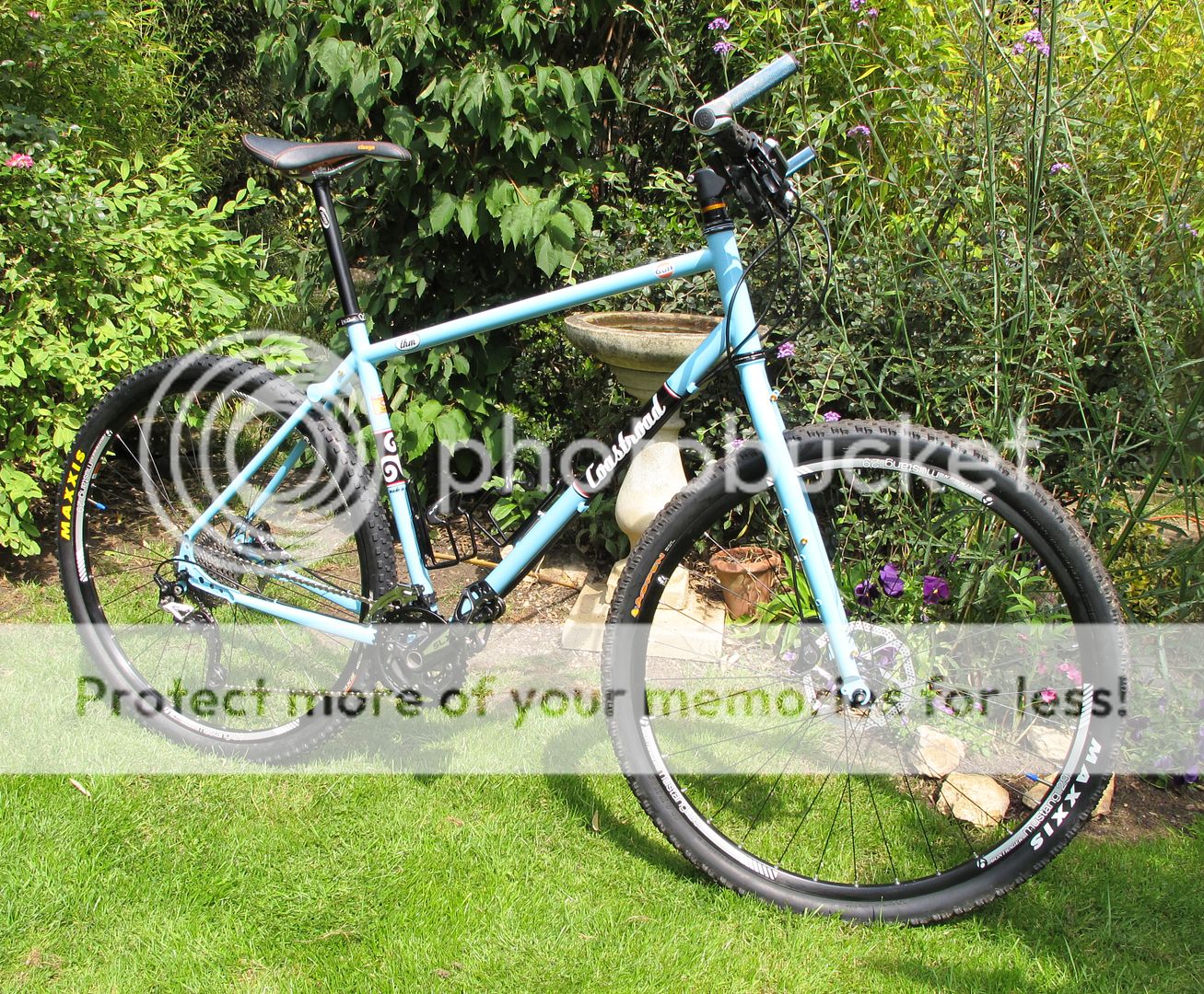

Couple of points/questions ....

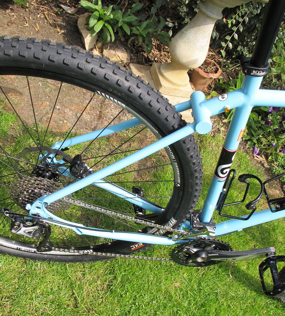

Why is the ST slot on the wrong side for a UK frame ;-)
The caliper adapter on your front brake is the wrong way up. Flipping it will give you more/the correct pad rotor contact.

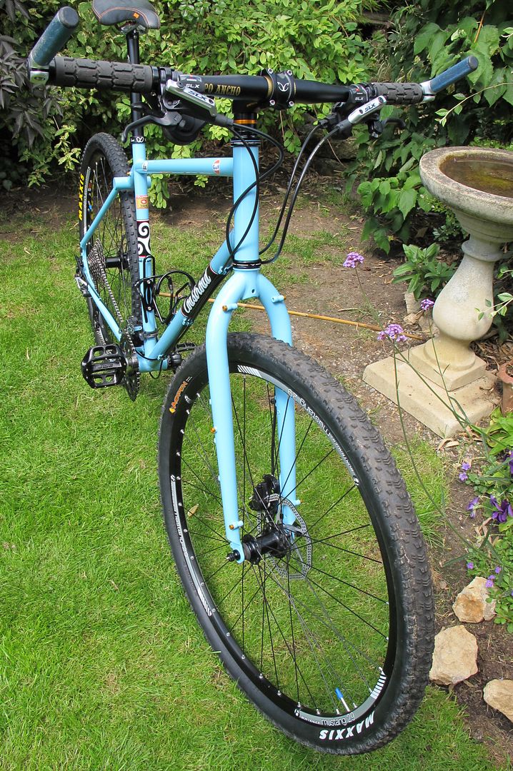

Thanks for that. Kind of done for now. Chain that came with group too short. Still needs bleeding and final tweaks with new chain. Other than that not bad....

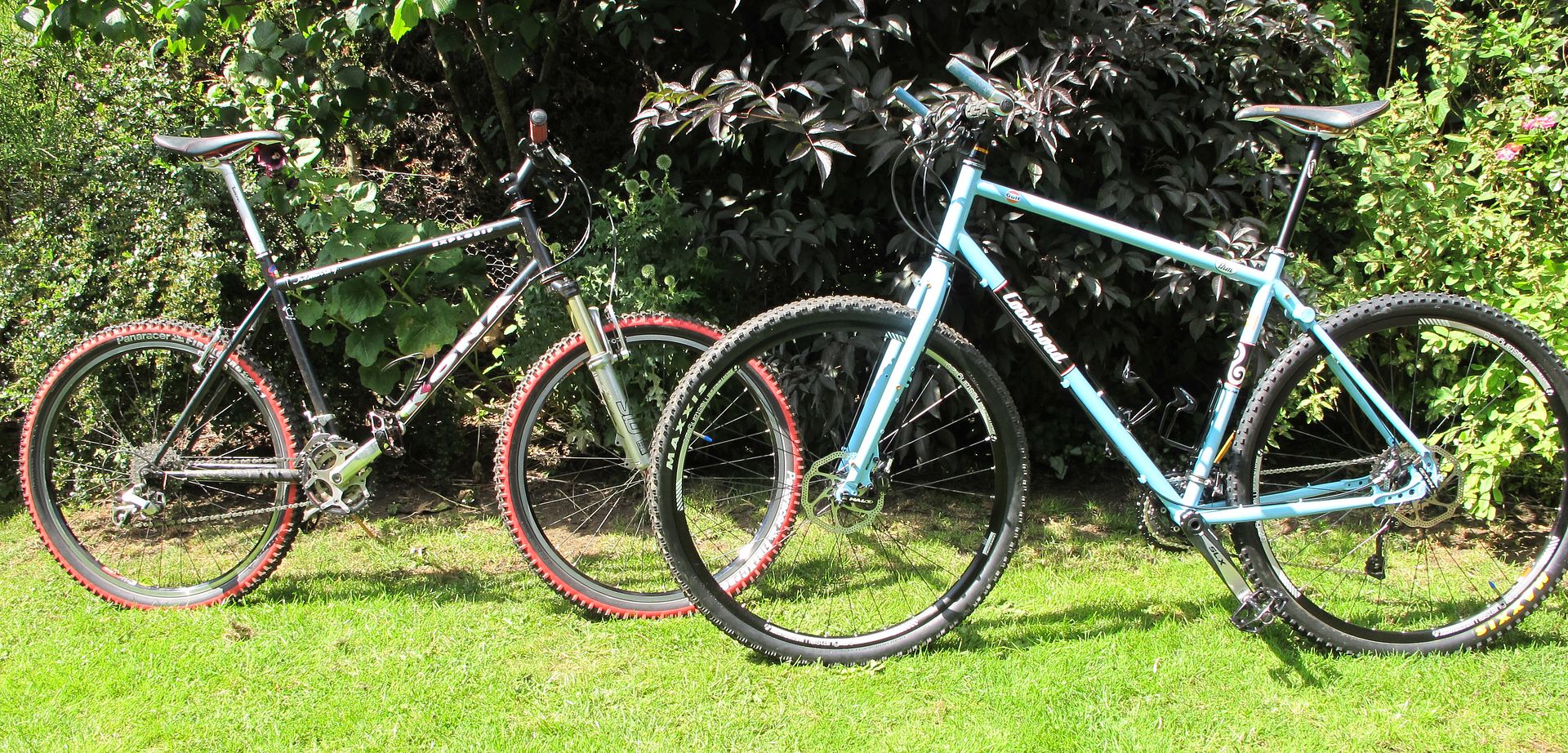

Hard to get the scale of it. With 20" explosif
ST slot?
Will try flipping the adapter. Had it the other way up at first :facepalm: Maybe that's why i cant get clearance?
Like i said. keep it coming. All good. Won't be offended by anything constructive/helpful.
Thank god for YouTube. Brakes bled, gears finally but not finely adjusted. Flipped the brake mount and flipped it back again. Sorry but it was the right way. Quick ride up the road. Then flipped the stem and weighed it as I wasn't sure if it was me. 13kg. Way lighter than the cooker. Shakedown with decent pics after trip to inlaws tomorrow.
Still a little jangle but no resistance from the discs. Wheels settle valves down. Annoying all the same. Do they bed in?
